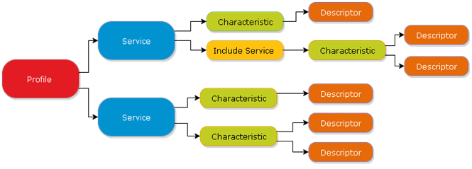

      GATT Database establishes a hierarchy to organize attributes. These are the Profile, Service, Characteristic and Descriptor. Profiles are high level definitions that define how services can be used to enable an application and Services are collections of characteristics. Descriptors are defined attributes that describe a characteristic value.
To define a GATT Database several macros are provided by the GATT_DB API.
Figure 2. GATT database

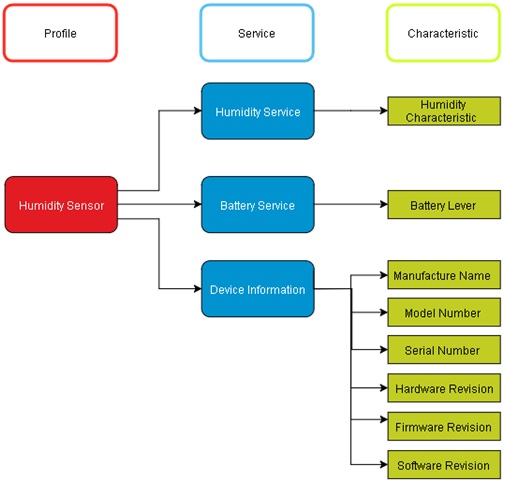

Figure 3. GATT database of Humidity Sensor
     First thing to do is define the Humidity Server that has 16 bytes.

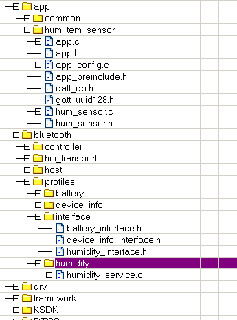

     After that, create a folder humidity in the next path C:\....\KW40Z_BLE_Software_1.1.2\ConnSw\bluetooth\profiles. Found the temperature folder, copy the temperature_service and paste inside of the humidity folder with another name (humidity_service)
Then go back and look for the interface folder, copy temperature_interface and change the name (humidity_interface) in the same path.
     On the humidity_interface file should have the following code.

1. Drag the files into the corresponding folder. The principal menu is going to see like this.
Figure 4. Principal Menu

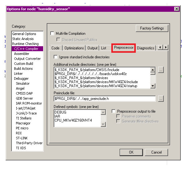

3. Click on the C/C++ Compiler and then on the Preprocessor
    Figure 6. Preposcessor Window

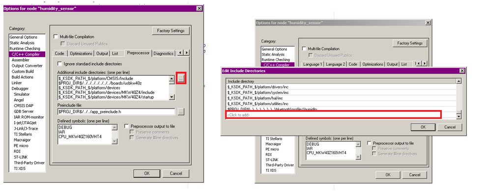

4. After that click on  "..." button to edit the include directories and then click to add a new path.
     Add the <kw40zConnSoft_intall_dir>\ConnSw\bluetooth\profile\humidity path.
Figure 7. Add a path
