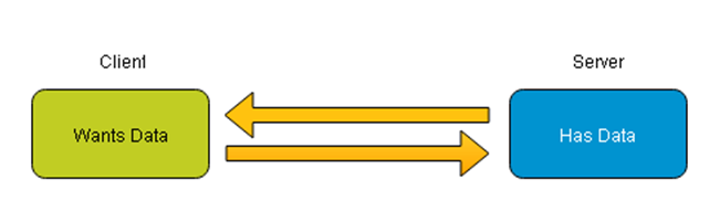

The first thing to know is that the Generic Attribute Profile (GATT) establishes in detail how to exchange all profile and user data over a BLE connection. GATT deals only with actual data transfer procedures and formats. All standard BLE profiles are based on GATT and must comply with it to operate correctly. This makes GATT a key section of the BLE specification, because every single item of data relevant to applications and users must be formatted, packed, and sent according to the rules.
GATT defines two roles: Server and Client.
  • The GATT server stores the data transported over the Attribute Protocol (ATT) and accepts Attribute Protocol requests, commands and confirmations from the GATT client.
  • The GATT client accesses data on the remote GATT server via read, write, notify, or indicate operations. Notify and indicate operations are enabled by the client but initiated by the server, providing a way to push data to the client. Notifications are unacknowledged, while indications are acknowledged. Notifications are therefore faster, but less reliable.
Figure 1. GATT Client-Server

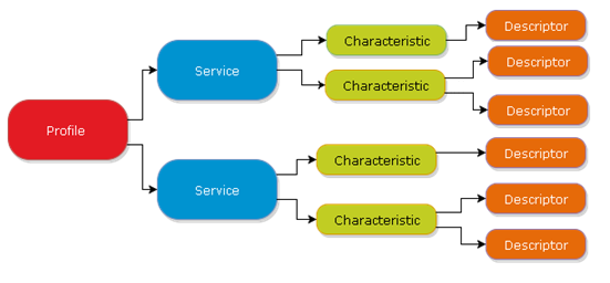

     GATT Database establishes a hierarchy to organize attributes. These are the Profile, Service, Characteristic and Descriptor. Profiles are high level definitions that define how services can be used to enable an application and Services are collections of characteristics. Descriptors defined attributes that describe a characteristic value.
To define a GATT Database several macros are provided by the GATT_DB API in the Freescale BLE Stack, which is part KW40Z Connectivity Software package.
Figure 2. GATT database

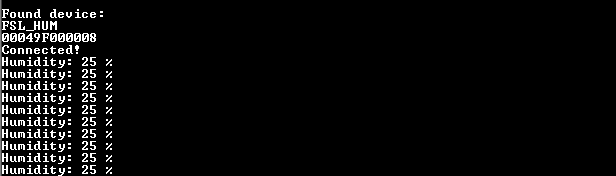

For test the demo fallow the next steps:
  1. Compile the project and run.
  2. Press SW1 for the advertising/scanning mode, and
    wait to connect it.
  3. Once the connection finish, press the SW1 of the
    Humidity Sensor board to get and print the data.
Enjoy the demo!
NOTE:
This demo works with the Humidity Sensor demo. This means that you need one board programmed with the Humidity Sensor application and a second board with the Humidity Collector explained in this post.
Figure 3. Example of the Humidity Collector using the Humidity Sensor.
