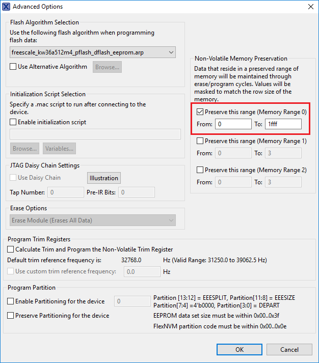

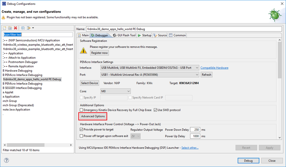

Regarding to the "Reprogramming a KW36 device using the OTAP Client Software" and "Reprogramming a KW35 device using the OTAP Client Software" documents, there are some additional steps to debug the OTAP client software in the specific case when you use MCUXpresso together with a P&E micro debug probe. Just before to program the OTAP client project (the second software), the user must do the following:
  1. Open the "Debug Configurations" view clicking on the green bug as depicted below.pastedImage_13.png
  2. Go to the "Debugger" perspective and search the "Advanced Options" button.pastedImage_7.png
  3. Enable the "Preserve this range (Memory Range 0)" checkbox, and edit the textbox "From: 0" To: 1fff" for the KW36 device or "From: 0 To: 3fff" for the KW35 device.pastedImage_15.png
  4. After to flash the device, disconnect and connect again. If everything it's OK, the RGB LED must blink (If you are using an FRDM board).
Then, test the demo as described in the document.
