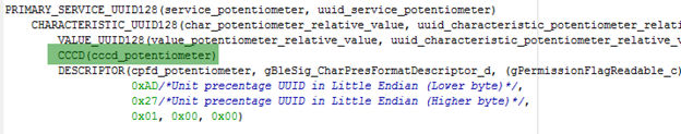

Once proper UUIDs have been stablished, the new service must be added to the GATT database. It is defined in the file gatt_db.h. Simple macros are used to include each of the attributes in the proper order. Following code shows the implementation of the potentiometer service in gatt_db file.
PRIMARY_SERVICE_UUID128(service_potentiometer, uuid_service_potentiometer)
    CHARACTERISTIC_UUID128(char_potentiometer_relative_value, uuid_characteristic_potentiometer_relative_value, (gGattCharPropRead_c | gGattCharPropNotify_c))
        VALUE_UUID128(value_potentiometer_relative_value, uuid_characteristic_potentiometer_relative_value, (gPermissionFlagReadable_c ), 1, 0x00)
        CCCD(cccd_potentiometer)
        DESCRIPTOR(cpfd_potentiometer, gBleSig_CharPresFormatDescriptor_d, (gPermissionFlagReadable_c), 7, gCpfdUnsigned8BitInteger, 0x00,
                   0xAD/*Unit precentage UUID in Little Endian (Lower byte)*/,
                   0x27/*Unit precentage UUID in Little Endian (Higher byte)*/,
                   0x01, 0x00, 0x00)
PRIMARY_SERVICE_UUID128 (service_name, service_uuid) defines a new service in the GATT database with a custom 128-bit UUID. It requires two parameters; service_name is the name of this service in the code and it is used later during the program implementation. Service_uuid is the identifier for the service UUID previously defined in gatt_uuid128.h.
CHARACTERISTIC_UUID128 (characteristic_name, characteristic_uuid, flags) defines a new characteristic inside the previously defined service with a custom 128-bit UUID. It requires three parameters; characteristic_name is the name of the characteristic in the code, characteristic_uuid is the identifier for the characteristic UUID previously defined in gatt_uuid128.h. Finally, flags is a concatenation of all the characteristic properties (read, write, notify, etc.).
VALUE_UUID128 (value_name, characteristic_uuid, permission_flags, number_of_bytes, initial_values…) defines the value in the database of the previously defined characteristic. Value_name is an identifier used later in the code to read or modify the characteristic value. Characteristic_uuid is the same UUID identifier for the previously defined characteristic. Permission_flags determine how the value can be accessed (read, write or both). Number of bytes define the size of the value followed by the initial value of each of those bytes.
CCCD (cccd_name) defines a new Client Characteristic Configuration Descriptor for the previously defined characteristic. Cccd_name is the name of the CCCD for use later in the code. This value is optional depending on the characteristic flags.
DESCRIPTOR (descriptor_name, descriptor_format, permissions, size, descriptor_bytes…) defines a descriptor for the previously defined characteristic. Descriptor_name defines the name for this descriptor. Descriptor_format determines the type of descriptor. Permissions stablishes how the descriptor is accessed. Finally the size and descriptor bytes are added.
