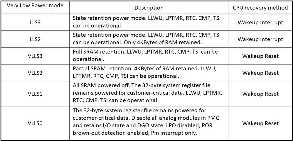

The MCU in the KW40/30Z has various available very low power modes. In these power modes, the chip goes to sleep to save power, and it is not usable during this time (it can however receive different kinds of interruptions that could wake it up). The very low power modes supported by the microcontroller are:

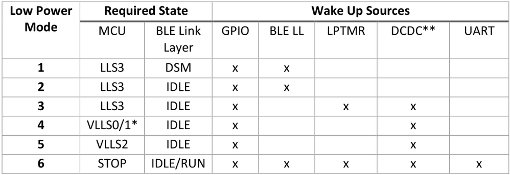

The KW40Z connectivity software stack has 6 predetermined deep sleep modes. These deep sleep modes have different configurations for the microcontroller low power mode, the BLE Link Layer state and in which ways the device can be awaken. These predetermined DSM (Deep Sleep Modes) are:
* VLLS0 if DCDC is bypassed. VLLS1 with either Buck or Boost.
** Available in Buck mode only.
Having said that, if you want the lowest possible consumption by the MCU, while also being able to wake up your application automatically with a timer (achieved with VLSS1), there is no DSM available. You can, however, create your own Deep Sleep Mode with low power timers enabled. Please note that VLSS1 has the lowest possible consumption when using a DCDC converter. When in bypass mode, the lowest possible consumption is achieved with VLSS0.
