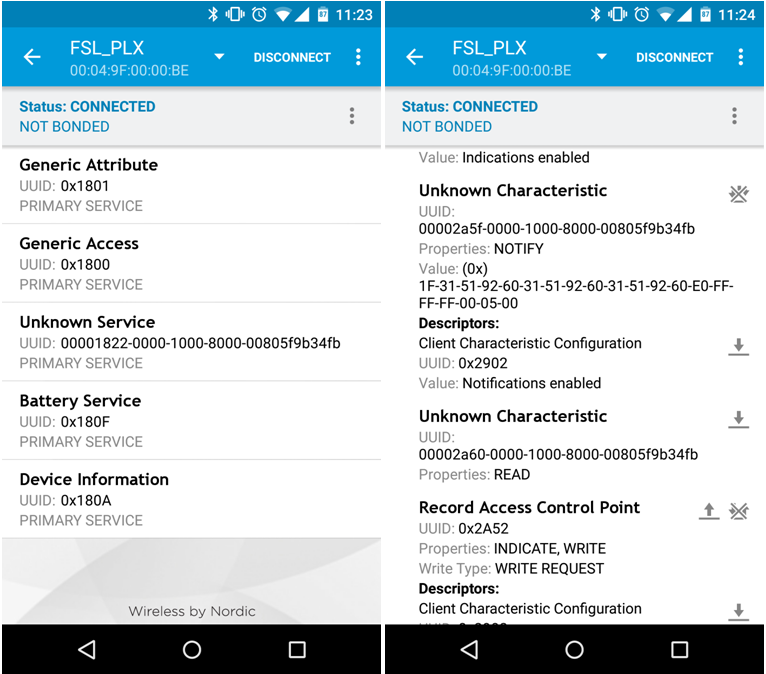

To test the demo you can download and install the nRF Master Control application by Nordic Semiconductor on an Android Smartphone that supports BLE. This app lets you discover the services in the sensor and interact with each characteristic. The application will parse known characteristics, but because the PLX profile is relatively new, these characteristics will not be parsed and the values will be displayed in a raw format.
Figure 1. nRF Master Control app
