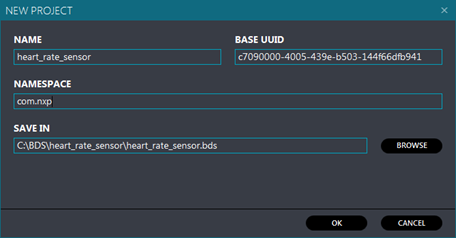

Create a new project by clicking FILE-> NEW PROJECT. Add project location, name and namespace as detailed below:

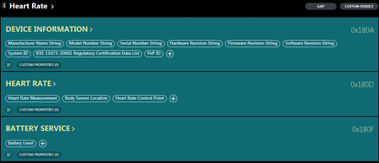

Drag and drop an adopted Heart Rate Profile from the right hand side list. Your device should import the following services:

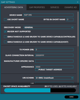

Next step will be to configure the GAP layer. Click on the GAP button. First tab will be the Advertising Data. Enter desired values and check which AD types you want to include in the advertising packets. A bar below will show you how much bytes your data uses. Make sure you do not use more than the 32 bytes available.

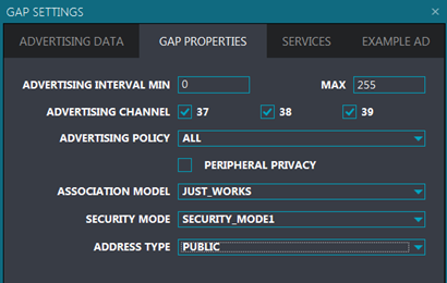

Next step is to configure the GAP properties. Make sure you check at least one advertising channel and a reasonable advertising interval range, as presented below:

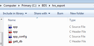

Click TOOLS->GENERATE CODE. Select Server as GATT side to be generated and NXP Semiconductors Kinetis v1.0.0 as the plug-in. BDS will prompt you to enter a location for the exported files.
After generating the files, another window with the results log will appear. If no error messages appear, the generation is successful. Check the “Open output location when finished” box and hit the “Finish” button. A folder with the following content will open:

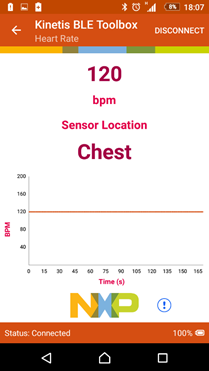

Before compiling the application add the following code snippet in app.c inside BleApp_HandleKeys:
case gKBD_EventPressPB2_c:
mUserData.cRrIntervals = 0;
mUserData.expendedEnergy = 100;
Hrs_RecordHeartRateMeasurement(service_heart_rate, 120, &mUserData);
break;
This will allow the board to send heart rate data of 120 bpm while in a connection and when pressing button SW3 on the FRDM-KW41Z board. The value can be seen when using Kinetis BLE Toolbox, as shown below:
