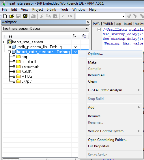

  1. Using IAR Embedded Workbench, open the application you want to send through OTAP.

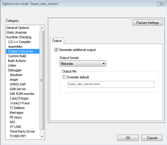

  3. In the options menu, go to the Output Converter submenu. In the Output Converter submenu, check the "Generate additional output" box, and choose Motorola as the Output format.                                                                                                                                                                            1.png

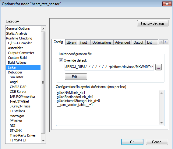

  4. In the options menu, go to the Linker submenu. Now, in the Config tab, replace the symbols in the Configuration file symbol definitions box with these:
    • gUseNVMLink_d=1
    • gUseBootloaderLink_d=1
    • gUseInternalStorageLink_d=0

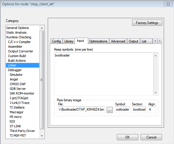

  5. In the Linker submenu, go to the Input tab. In the Keep symbols box, add the symbol 'bootloader' (without the quotes).
  6. In the Input tab, in the Raw binary image box, in the File option, add the following path:
    • $PROJ_DIR$\..\..\..\..\..\..\..\framework\Bootloader\Bin\BootloaderOTAP_KW40Z4.bin
  7. In the Raw binary image box, add the following options to the Symbol, Section and Align boxes:
    • Symbol: bootloader
    • Section: .bootloader
    • Align: 4                                                                                                                                                                                                                         1.png

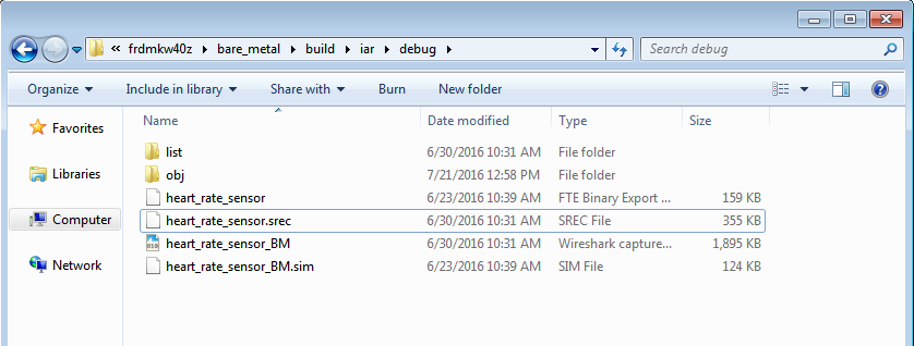

  8. Press OK. Compile the project. The output file (*.srec) should be in the main project folder, inside the debug folder.                                                      1.png
  9. You can now use this binary file to reprogram your device with OTAP.

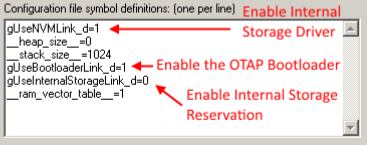

What is the use for:
__heap_size__=0
__stack_size__=1024
Bluetooth® Low Energy Application Developer’s Guide Rev. 1, 10/2015
