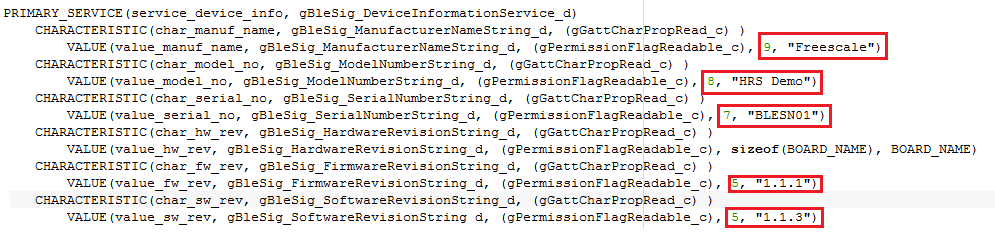

Modifying general device information
The BLE services information reported by the device is stored in a file named “gatt_db.h”. This services information is what is shown on a smartphone when the device has connected. The Generic Access Profile service includes the device name reported when advertising. To change it just replace the device name between “” and update the character count.
Detailed device information is accessed via the Device Information Service including the manufacturer name, model and serial number etcetera. This information can also be adjusted to the custom device requirements by modifying the string between “” and updating the character number.
