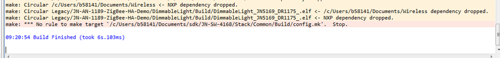

1. Wrong Path
A  common issue is a user uses another path for the installation of the SDK than the default one (C:\nxp\bstudio_nxp\workspace).
When trying to find the Makefile ("SDK/JN-SW-4168/Stack/Common/Build/config.mk"), the IDE uses a relative path, for that reason it assumes that the file is in the correct directory. As the path was changed, the file can’t be found.
2.Project Directory
After you select the Application Note (AN) you want to import remember that there will be an option for the JN517x as most of the projects are compatible between them (Zigbee 3.0, ZigBee Link Light).
Nonetheless, BeyondStudio is not compatible with the JN517x.  While importing the project you only must select the JN516x project and none of the options must not be selected.
Linking Errors
Open a source file (.c) or a header file (.h),  you will notice that the IDE shows a lot of errors even though the project has not been compiled yet.
The errors you are seeing is Eclipse not being able to resolve various variables and functions within the SDK.
You might see some errors like: Symbol “xxx” could not be resolved for example.
After starting the compilation process, look at the console log and notice that the bin file is being generated correctly.
Do not try to add another file in the path and Symbols trying to avoid all those errors; the IDE will look for the includes that the project needs.
If you used the default path location, it will not have any problem with the compilation.
The OS_Gen, ZPS_Gen, and PDUM_Gen, for example, are all files automatically generated based on the configuration files, performing a clean will remove those files but will be created again after a new compilation.
