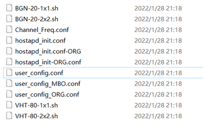

Hello @nandan-khant ,
Check utils/config directory, please!
all configuration files and scripts are here.  sta_name, uap_name & wfd_name can be modified in config or script files.
for example, user_config.conf
[DUT_Settings]
sta_interface=mlan0
p2p_interface=wfd0
mmh_interface=uap0
