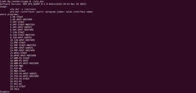

weidong_sun
Hello @nandan-khant
I run wfa_dut & wfa_ca successfully on imx platform + android 11.
Below is my steps:
1. Getting android ndk
# cd /opt/
# sudo git clone https://github.com/urho3d/android-ndk.git
2. Creating cross compilation toolchain
# cd android-ndk
# sudo build/tools/make_standalone_toolchain.py --arch arm64 --api 26 --install-dir=/opt/ndkroot
then ndkroot will be created and full toolchains are in the directory.

4. Changing configurations of Makefile.inc
Go back to ~/WTS-DUT-AGENT/NXP_WTS_AGENT_Source-R1.9/SRC/R-1.9-Android-SRC, open Makefile.inc and change it.
# cd ~/WTS-DUT-AGENT/NXP_WTS_AGENT_Source-R1.9/SRC/R-1.9-Android-SRC
# gedit Makefile
NDKROOT=/opt/ndkroot/bin
PLATFORM=/opt/ndkroot/sysroot
CROSS_COMPILE=$(NDKROOT)/aarch64-linux-android-
CC=${CROSS_COMPILE}gcc
save & exit
5. Cross compilation
# make all
after compilation is done, NXP_WTS_AGENT_IMX_Android_bin directory is created.

7. Try to run wfa_dut & wfa_ca
# sudo adb shell
# cd /vendor/sigma
# ls
1|mek_8q:/vendor/sigma # ls
wfa_ca wfa_dut
# ./wfa_dut
=========logs=================
|mek_8q:/vendor/sigma # ./wfa_dut
Software Version: NXP_WTS_AGENT_R-1.9-Android(01:34:43 Nov 16 2022)
Usage:
wfa_dut -v (version)
wfa_dut <interface> <port> <program_index> <wlan interface name>
where programs:
1.HE-STAUT
2.HE-APUT-HOSTAPD
3.VHT-STAUT
4.VHT-STAUT-MWIFIEX
5.VHT-APUT-UAPUTL
6.VHT-APUT-HOSTAPD
7.11N-STAUT
8.11N-STAUT-MWIFIEX
9.11N-APUT-UAPUTL
10.11N-APUT-HOSTAPD
11.PMF-STAUT
12.PMF-STAUT-MWIFIEX
13.PMF-APUT-UAPUTL
14.PMF-APUT-HOSTAPD
15.WPA3-STAUT
16.WPA3-APUT-HOSTAPD
17.WMM-PS-STAUT
18.WMM-PS-APUT
19.WMM-PS-APUT-HOSTAPD
20.P2P-MWU
21.P2P-WS
22.MBO-STAUT
23.FFD-VU-APUT-UAPUTL
24.FFD-VU-APUT-HOSTAPD
25.FFD-VU-STAUT
26.HS2-R1
27.HS2-R2
28.V-E-STAUT
29.TDLS
Example:
wfa_dut lo 8000 5 wlan0
1|mek_8q:/vendor/sigma # ./wfa_ca
File wfa_ca.c, Line 131: Usage: ./wfa_ca <control interface> <local control agent port>

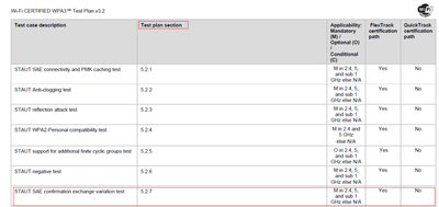

weidong_sun
Hello @nandan-khant ,
OK, understand your situation.
According to your above descripitons, these test plans didn't pass in WFA lab, Wi-Fi4, Wi-Fi5, SVD, FFD, WPA2SI, PMF, and WPA3-R2+R3.
Please follow thest steps to create ticket in our system FOR EACH test plan.
For example:
1. WPA3-R3 test plan
In Wi-Fi_CERTIFIED_WPA3_Test_Plan_v3.2,  chaper "3.2.2 STAUT test applicability",
if "STAUT SAE confirmation exchange variation test" failed, It will be better if you use 5.2.7_STAUT_SAE_ confirmation_exchange_variation_test named your log's file name.

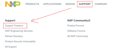

2. Create a ticket via nxp website www.nxp.com
SUPPORT--->support ticket--->Create New Case
weidong_sun_0-1668737336020.pngweidong_sun_0-1668737336020.pngweidong_sun_1-1668737377968.pngweidong_sun_1-1668737377968.png
in your ticket, you should provide these information:
(1) Driver / Firmware version
(2) Android platfor information
(3) Hardware platform information
(4) Siniffer logs
(5) if you have ucc logs, provide it, please!
(6) wpa_supplicant version (the one in android 11 or from open source v2.10)
(As I am known, wpa_supplicant in android 11 doesn't support WPA3-R3, but in android 12, no problem)
(7) wpa_supplicant.conf
we need it's detailed configurations of wpa_supplicant.conf
Then I will share above information with internal team, and analyse it together.
Thanks!
