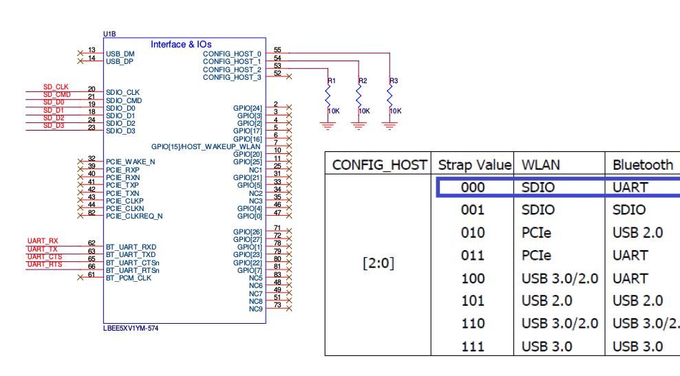

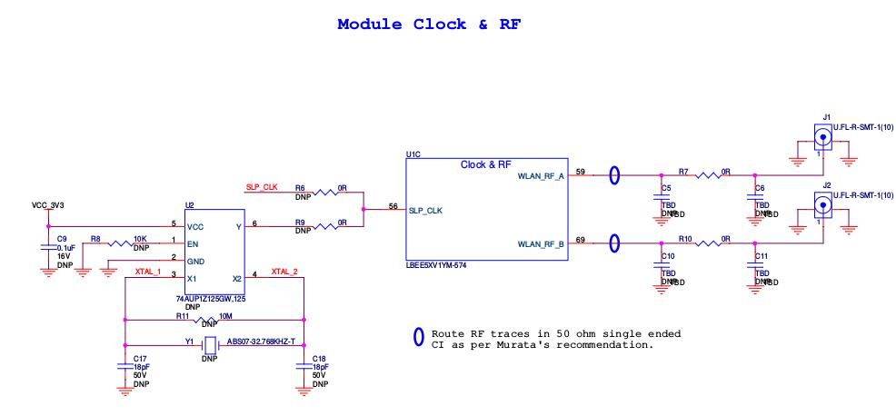

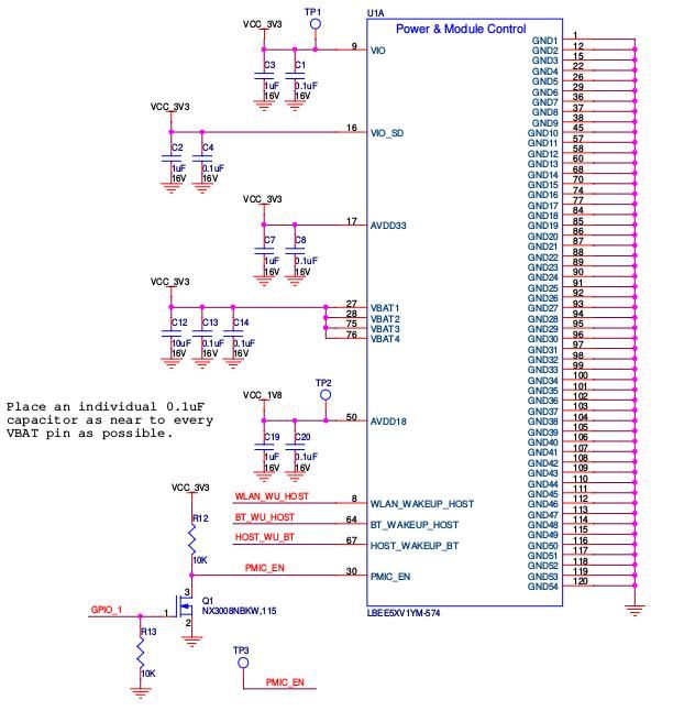

Hello NXP Team, @igorpadykov
We are using the “Murata LBEE5XV1YM” module which is based on the “NXP 88W8997” chipset.
We are facing the attached crash while using AP mode. Request you to please guide us to get rid of the same.
Setup Details:
  • Processor:  iMX6DL processor
  • Linux Kernel Version:  4.1.15
  • Wi-Fi Chipset: NXP 99W8997
  • Wi-Fi Linux Kernel Driver Link: Kindly check this thread.
  • Initial crash logs (Below Table): Please refer the attahced logs for more details.
mmc1: Timeout waiting for hardware interrupt. retries left=0 opcode=0
host_to_card, write iomem (1) failed: -1
write CFG reg failed
watchdog watchdog0: watchdog did not stop!
Timeout cmd id (147.120063) = 0xce, act = 0x3400
ce 00 16 00 61 10 00 00 00 34 e9 11 62 ef cd 01
BSS type = 1 BSS role= 1
------------Dump info-----------
Commmand Timeout
mlan_processing =1
main_lock_flag =0
Here is the schematic snapshot.

stephanie_m
As this ticket has been discussed internally , this is just to add the information as reference
As you might know, we have 2 kind of driver releases:
  • Specific FP68 (Feature Pack 68) releases like the one you were using
  • MGPL driver : Generic FP92 releases, which include less features, but still fit to many customer needs.
Could you please try compiling the driver ?
