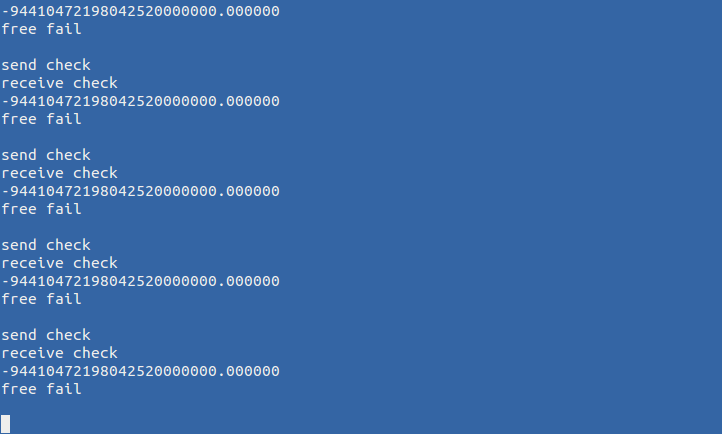

I can free the buffer on the A5, but it doesn't free the buffer on the M4. And the message from the M4 doesn't get saved to the textfile.
Did I use the function "mcc_recv_nocopy" correct?

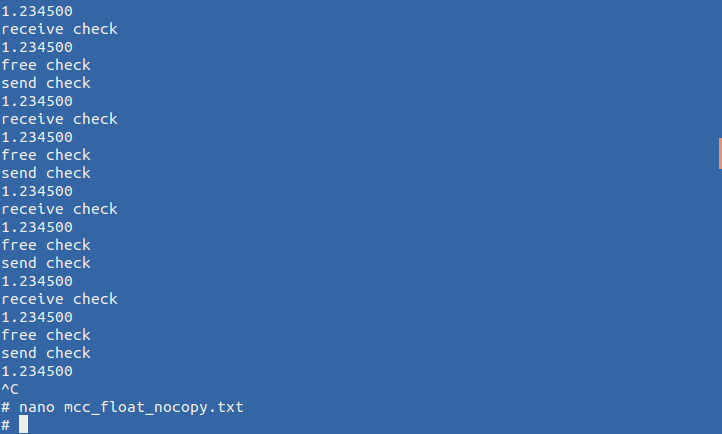

christianedhofe
Thanks Timesys Support for the quick response.
I double checked my program, but it still doesn't work properly. I didn't mention that I would like to examine the timing of the MCC. I did this with the mcc_recv_copy function and I would like to do the same with mcc_recv_nocopy, because I read that this function should be faster.
I also attached two screen shots of the outputs of both cores. I'm still wondering why the M4 is not able to free the buffer. And the program stops after nine repetitions but it should stop after ten. So I don't get the "Finish" message from the A5. Thanks again for your help.
Best,
Christian

A5 screen shot:
M4 screen shot:

Hi Christian,
Great, thanks for the info. I would recommend using MQX 4.0.2 - this will likely solve your issue. In the future, you can put a version check string in your application to ensure you are using compatible versions of the MCC library. For example, in your Linux application source:
// initialize the sub-system
ret_value = mcc_initialize(THIS_NODE);
if (ret_value != MCC_SUCCESS)
        printf("CA5:Error: mcc_initialize error: %d for node: %d\n", ret_value,
                        THIS_NODE);
        return ret_value;
// verify compatible versions
ret_value = mcc_get_info(THIS_NODE, &mcc_info);
        printf("CA5:Error: mcc_get_info error: %d for node: %d\n", ret_value,
                        THIS_NODE);
        return ret_value;
            if (strcmp(mcc_info.version_string, MCC_VERSION_STRING) != 0)
        printf("CA5:Error: different versions of the MCC library on each core!\n");
        mcc_destroy(THIS_NODE);
        return MCC_ERR_DEV;
Here is the link to download MQX 4.0.2 sources:
http://www.freescale.com/webapp/Download?colCode=FSLMQXOS_4_0_2_GA&appType=license&location=null&Par...
Can you try rebuilding your application using this, and let me know if the timing improves.

johannestraxler
I also had problems with the MCC library of MQX 4.0.1 and I was affected by this bug described here: https://community.freescale.com/thread/320177
Maybe it's the same for your case! So what did I do? I downloaded the MQX 4.1.0 for Linux Beta, replaced the source files from there in my 4.0.1 directory and recompiled MCC. I know this might not exactly be a bulletproof solution, but I'm working on Phytec PCM052 platform and they haven't ported the new 4.1.0 BSP yet!
Hope this helps!
