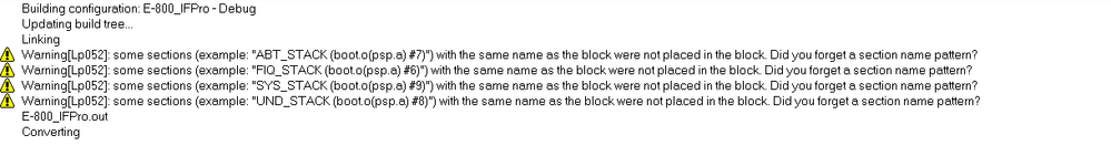

I have this four following warning from my linker config file (see picture):
Warning[Lp052]: some sections ....
I am using:
-IAR Embedded Workbench for ARM 7.60.1.11216
-MQX 4.2
-Processor is a vybrid
Linker config file is attached.
Maybe somone have a hint.

Hi Rainer,
MQX4.2 was developed for earlier IAR version. And my understanding is that the newest IAR versions have implemented many changes in the linker file. So you may try with an earlier version such as 7.3.
Please let me know your findings.
