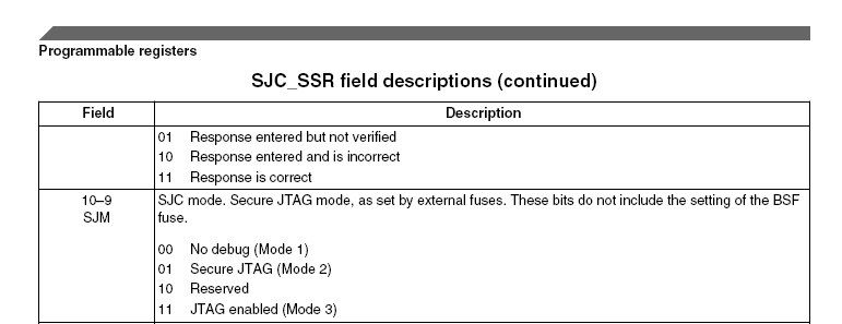

igorpadykov
Hi Inge
please check atatched file and i.MX6 System Development User’s Guide
(as it has similar jtag module)
http://cache.freescale.com/files/32bit/doc/user_guide/IMX6DQ6SDLHDG.pdf
igor

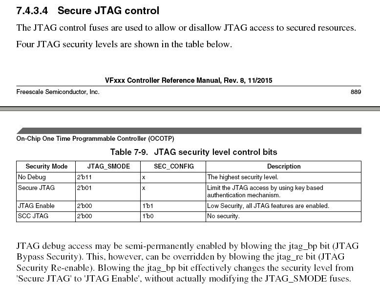

ingenikolaitors
JTAG_SMODE are '00' and SEC_CONFIG is '0', that means that i am in SCC JTAG mode with no security. So that doesn't seams to be the problem. I tried with gdb server as well, but got the same response:
