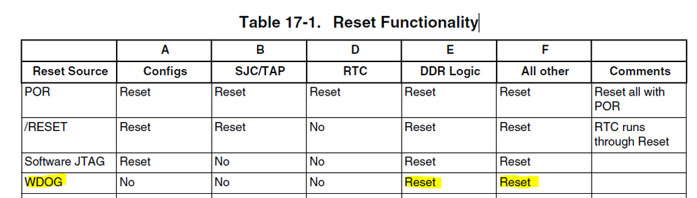

jiri-b36968
Hi Soichi,
yes IOMUX and DDRMC will be reset after WDOG reset. From  Table 17-1. Reset Functionality in RM:
/Jiri
