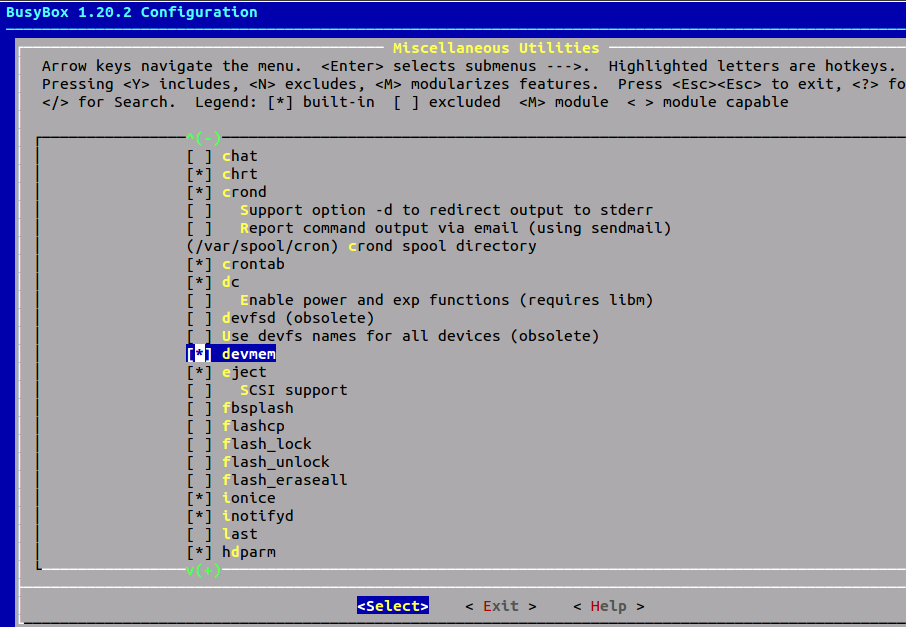

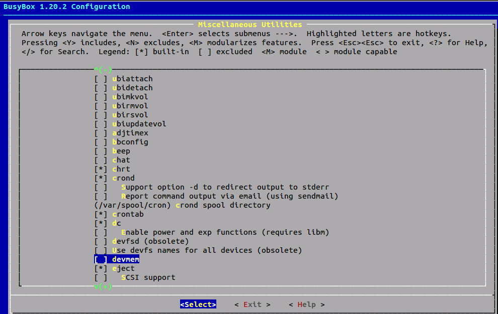

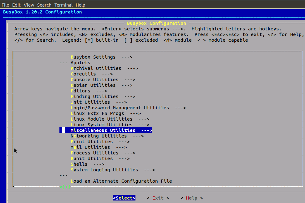

CurtisWald
The memtool is found in the imx-test package found in i.MX BSP's.  The command ./ltib -m prep -p imx-test will provide the sources in <ltib>/rpm/BUILD directory.
As Iospeh stated TimeSys does not today provide memtool in their offerrings.
Another user space application that is available in TimeSys Vybrid desktop factory is devmem which is found in the Busybox utilities. By default devmem is not enabled. Here are the steps to enable, build, and location in the root file system.
The BusyBox documentation has this description:
devmem
devmem ADDRESS [WIDTH [VALUE]]
Read/write from physical address
        ADDRESS Address to act upon
        WIDTH   Width (8/16/...)
        VALUE   Data to be written
This assumes you have downloaded, installed and built desktop factory once. (Not available from Web factory).
  1. make busybox-menuconfig
At the desktop factory top level directory issue the “make busybox-menuconfig” command which then shows the configuration menu. Using the keyboard arrow keys, down arrow and select “Miscellaneous Utilities then hit the enter key. This selects the Miscellaneous Utilities menu.
Using the down arrow key go down until devmem entry. Using the space bar select to enable and you will see [*] the item is selected.
Right arrow to exit and hit enter and then select yes to save.
2. make busybox-build
3. make busybox-rfs-install
This installs in the root file system. To see, change to the directory on your installation where the desktop factory is installed, for me I had :
cd /home/user/vybrid/factory/build_armv7l-timesys-linux-gnueabi/rfs/
$ find . -name devmem -print
./sbin/devmem
The root file system (rfs) now has the devmem utility.
