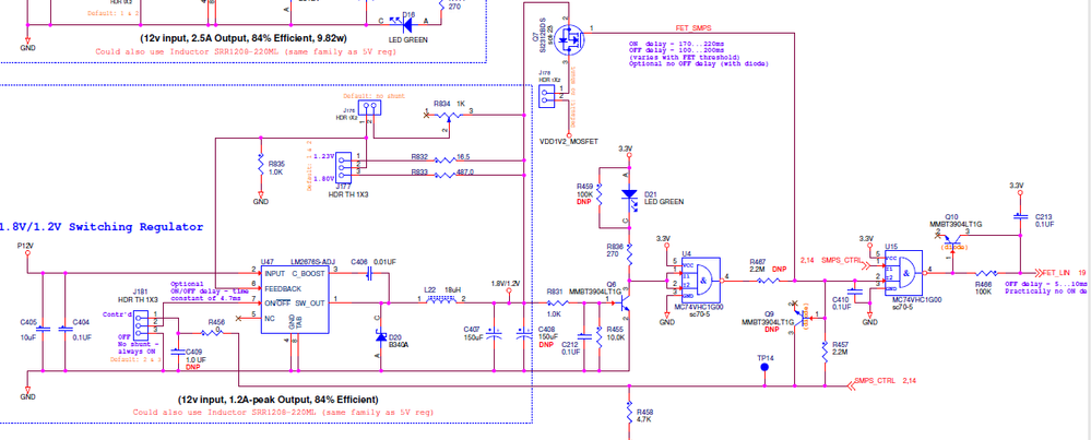

This inquiry directed to @Jiri Kotzian regarding AN4807 - Vybrid Power app note which he authored.
We are using an external switcher to supply the core power per the guidance of section 8.5 of the app note. The only difference is the BJT is being supplied from 1.8V instead of 1.5V in the app note.I believe the circuit in section 8.5 of the app note does not work in all cases, specifically when the 1.2V switcher voltage is less than what the internal LDO thinks the core voltage should be.
My questions specifically are:
  1.   Has Freescale or one of their customers successfully implemented the circuit shown in section 8.5 of the app note?
  2.   If so have they tested the case where the switcher supply is less than the internal LDO regulated voltage?
    3.   If yes is there something we are missing or have done incorrectly in our design or something we need to do internally in the processor to make this work (e.g. disable the BCTL signal)?  Besides the power issue I believe this may result in long-term damage (and a shortened life) of the part as I believe the current implementation is sourcing (significantly) more than the rated current out the BCTL signal.
  Attached is the schematic of that part of the circuit.  Other notes about our circuit and our observations below.
V1P2_GPP is connected directly to the GPP’s ( General Purpose Processor) core power input.
V1P2 is a switching power supply.
V1P2_SW_PWR_EN and V1P2_LDO_PWR_EN are connected to (3.3V) GPIOs on the Vybrid.
V1P2_BCTRL is connected to the Vybrid’s BCTL pin.
Our switcher output voltage is slightly lower than what the processor regulates to when using the LDO with the external BJT. When we move over to the switcher the BCTRL signal still seems to be trying to regulate the core supply. Because the switcher voltage is below what the LDO thinks it should be it drives (or tries to drive) the BCTRL signal to the rail (which seems to be 3.3V). This then seems to be backfed through the BJT to the 1.8V rail.
With the part installed I measure 1.8V at the collector, 1.8V at the emitter and ~2.6V at the base.
When I remove the part (after the processor has booted and moved to the switcher) I measure 1.8V at the collector, <100mV at the emitter, and ~3.2V at the base.
When I remove the part I see the 3.3V supply power drop by ~100mW, 1.8V power supply increase by ~30mW, and the overall power drop by ~50mW (so ~20mW is going somewhere else, I suspect the core rail itself).
This seems to be a fundamental issue with the design presented in the app note. (which I believe is implemented as presented in our design).

Presented below is the second FET circuitry from the schematic provided by Jiri. It controls the NPN transistor's connection.
Just to explain this schematic a bit:
- Ignore the switcher's output option of 1.8V as irrelevant for your use case.
- The RC values providing required timing for on/off/overlapping are preliminary and might need tuning.
- Transistors with only 2 pins connected are used as diodes; the only purpose of that was to simplify the board BOM.
In addition to what Jiri already mentioned, using glue logic lowers number of Vybrid's IOs used for the circuit control, which might be important in your use case.

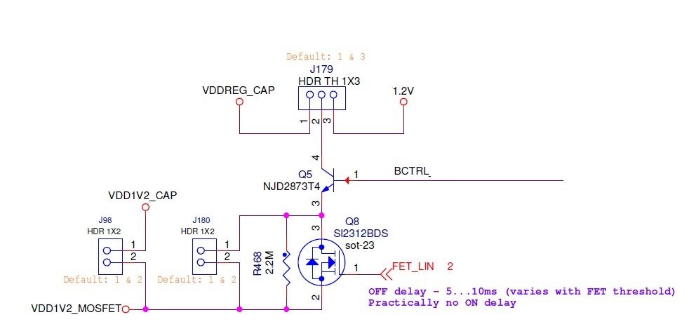

Hello Gordon,

One difference between out schematic and yours is the direction of the FET in line with the LDO (Q8 in your schematic above and Q10 in our schematic). If we reverse the FET it will prevent the LDO backfeeding onto the 1.2V processor supply.
What we also found however that BCTRL was being driven through the BJT back onto it's supply (1.2 or VDDREG_CAP in your schematic above) when the processor's LDO control thinks the input voltage is too low and the switcher was selected. It seems like this would be an issue with your circuit above, do you agree? We placed a diode in series with the BJT's collector and that seemed to fix things. That way even if BCTRL is being driven to the rail there are diodes blocking the path on both the emitter and collector.

Please, take a look at the Re: Power supply for Vybrid core thread, specifically my reply dated 'May 30, 2013 4:15 PM', which details the source-switching sequencing. The schematic Jiri and myself provided earlier is based on it.
The major principle of this approach is that "Vybrid powers up / down and switches between Power Modes same way as before", i.e. when it only uses the linear regulator!
Regarding your "If we reverse the FET, it will prevent the LDO back-feeding onto the 1.2V processor supply." statement. - The FET diodes' directions are to meet this requirement. E.g., when the linear regulator is running but the switch-mode one is not yet, the reverse-biased diode isolates the core power rail from the still unchanged switch-mode regulator's output capacitor (otherwise it would be charging from the core rail).
This requirement, to isolate 2 regulators from each other as much as possible, except for short period of time of their overlapping, is important for the switch-mode regulator as well - e.g., it is designed to be turned on with the output capacitor discharged.
Based on my support experience, some customers trying to "cut corners" to simplify the scheme have been experiencing issues with Vybrid and/or the switch-mode voltage regulator.
I am having difficulties understanding your "BCTRL was being driven through the BJT back onto it's supply... We placed a diode in series with the BJT's collector and that seemed to fix things" phrase, used diodes, etc. If it is still applicable, may you provide more details, please, like illustrations, etc.?
[Please, also take a look at the newly published http://cache.freescale.com/files/microcontrollers/doc/user_guide/VYBRIDHDUG.pdf.]

Regarding your last point about my comment on the BCTRL signal I'll use your circuit as an example.
Assume that the LDO is regulated by the processor to 1.2V but the switcher puts out a slightly lower voltage. When the processor is transitioned over to the switcher the LDO control will still be trying to regulate the core voltage via the BCTRL signal. Because the input voltage is lower than it expects it will drive the BCTRL signal higher in an effort to raise the core voltage (which will not work because it's no longer actually controlling core voltage, the switcher is). The FET (Q8 in the schematic above) is open so no current will be able to flow out the emitter of the BJT. The collector is at VDDREG_CAP in your circuit (or whatever J179 is jumpered to), on our board it's 1.8V. It appears that BCTRL can be driven to 3.3V. This puts the base of the BJT at ~3.3V and the collector at 1.8V, forward biasing the b-c junction and current flows from the base to the collector, effectively backfeeding the supply with as much current as BCTRL is capable of suppling.
Does this make sense?
12,964件の閲覧回数
naoumgitnik
Senior Contributor V
Dear Eric,
Thaks for your explanation - now I see what you mean.
We do not have such an issue in our design - the collector is at 3.3V, i.e. always at higher voltage than the BCTRL pin.
If having 1.8V on the collector is mandatory in your design, you will indeed need a diode in series with the collector (better of a Schottky type - to lower voltage drop).
Regards, Naoum Gitnik.
12,964件の閲覧回数
ericaverill
Thanks Naoum, so you would agree that the solution for this fix is to either use 3.3V as the supply to the BJT or to add a diode in series with the collector of the BJT?
12,965件の閲覧回数
naoumgitnik
Yes.
