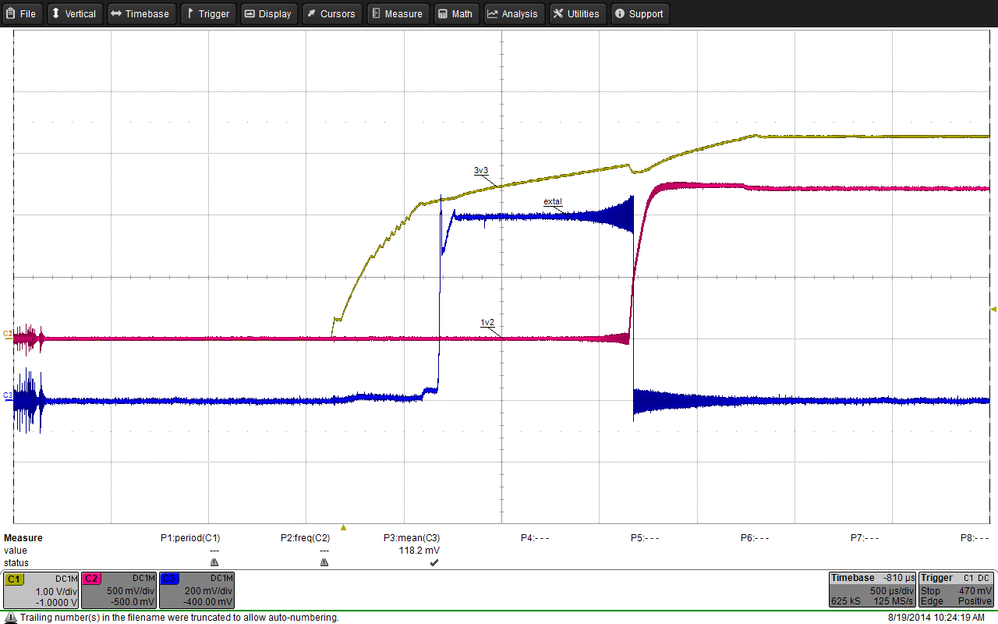

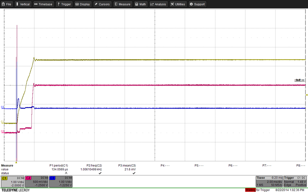

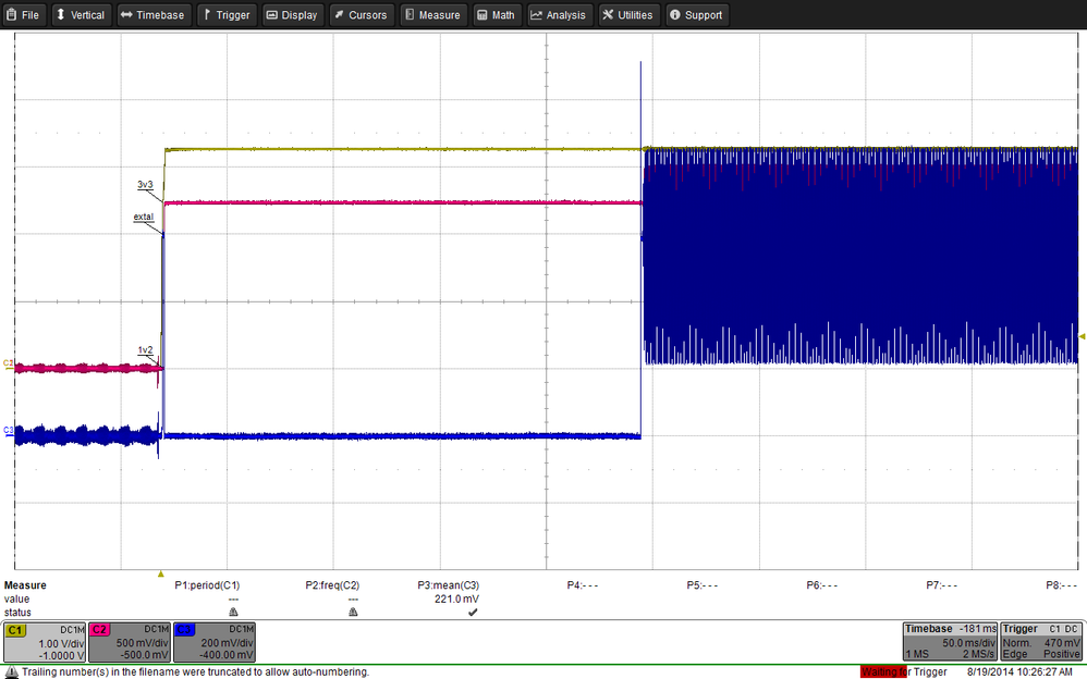

Pic1 below: power up, all boards start up like this.
Pic2 below: good boards set EXTAL to 0.6V like on the pic, on bad boards EXTAL stays low forever...

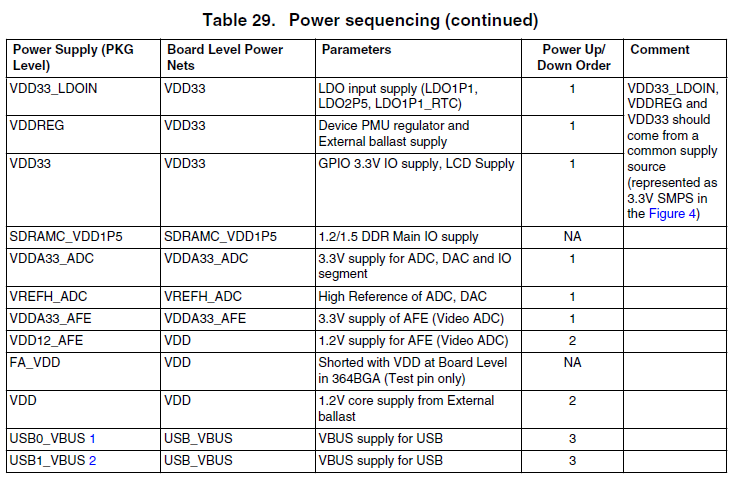

Relating to the power sequencing table from the Datasheet:
- The voltages VDD33_LDOIN, VDDREG, VDD33 are supplied from the same power rail.

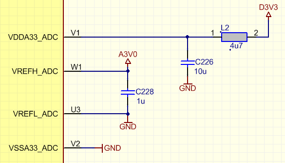

- VDD33_ADC is supplied also from the same power rail, but filtered:
- VREFH_ADC is switched on by application and comes later (but it mades no difference, when i applied this supply from beginnings)
- VDDA33_ADC is not used and tied to GND. (On the hardware development guide, its new defined to tie it to 3V3 if unused)

Dear Benno,
Thanks for the information sent - everything is correct.

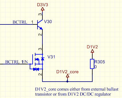

The 1V2 are generated with an external ballast transistor.
There is also the possibility to switch to another power source, but ist not used yet. (BCTRL_EN always high)
D1V2_core is connected to all VDD1-VDD23 and FA_VDD pins, and there are >20 100nF capacitors on these pins, placed as near as possible (like on the tower board).
And DECAP_V11_LDO_OUT has a 10uF capacitor.
This is the whole 1V2 power rail. I think, there can't be so much wrong?

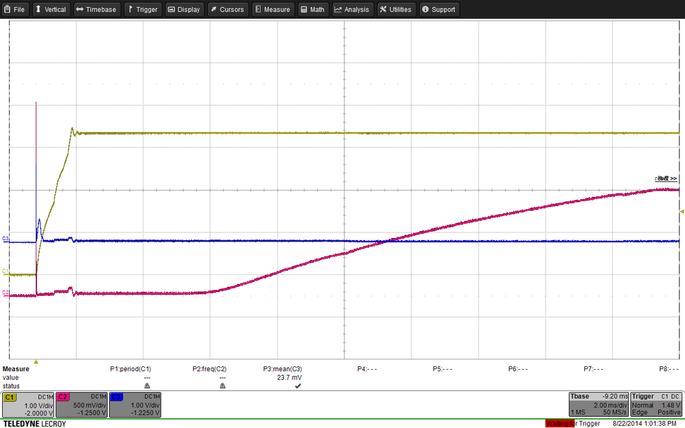

bennojung
Hello Naoum
Yes your right, it has something to do with the power up sequence.
For smooth switching between ballast transistor and DC/DC supply, we switched the FET BCTRL_EN very slowly. On power up, the 1V2 supply goes up also slowly. This seems to be a problem.
On first picture below, the controller doesn't start. On second pic, it starts. (yellow: 3V3, red: 1V2). I'm bit confused, because the start sequence is the same, and the controller is the whole power up sequence in reset state anyway?
But im looking forward to solve the problem... thanks for your help!
18,112 Views
naoumgitnik
Senior Contributor V
Dear Benno,
So, the problem is related to "switching between ballast transistor and DC/DC supply"? - It was not clear from the original data provided...
There is no need to "...switch... the FET BCTRL_EN very slowly"; it can be fast but just follow 2 rules here:
  1. Your D1V2, (i.e. external to Vybrid) shall be stable prior to the power source switching; based on your first scope screenshot, it looks like you do it in the opposite order - the D1V2DC/DC converter is just enabled and charges capacitors on its output.
  2. power coming from it and that from the ballast transistor should overlap, e.g., for a few tens of ms, until you disconnect the ballast transistor.
(All this is explained in the AN4807 "Vybrid Power Consumption and Options” Application Note.)
While testing this scheme, we simply used 2 mechanical switches and did this switching manually while watching the D1V2_core rail for any disturbances (saw none).
BTW, you provided no timing data for the RESET_B signal; I am even suspecting it is only related to 3.3V rail but not 1.2V... and, as you can see, its Logic High enables the oscillator we are discussing.

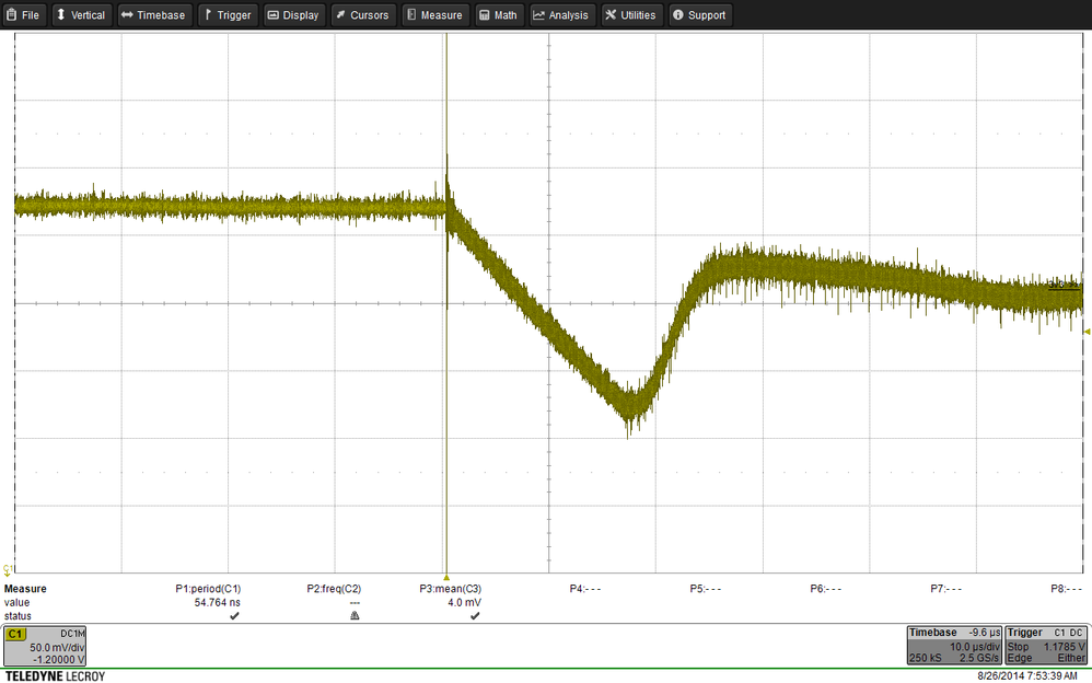

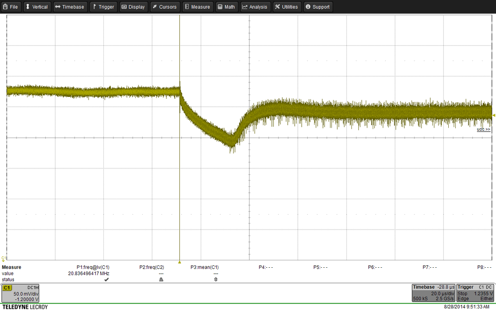

Heres a picture from the power switching. The ballast transistor (~1.26V) is hard switched off. The DC/DC converter starts working when the voltage drops below 1.2V, and then it needs about 12us to stabilize the voltage.(10us/div, 50mV/div). This is enough for the voltage to fall to 1.12V. I think, this is the case with every DC/DC converter, when the voltage of the ballast transistor is over the output of the converter? Or what looks like the VDD switching on your boards?
This was the reason to switch the ballast transistor slowly, then we could minimize the voltage drop to 20mV or so.

Hello Naoum
Yes a voltage dip is always there, as long as the voltage from the converter is lower as the voltage from the ballast transistor.
With the resistors on the converter feedback loop, the converters output is some a little higher than 1.2V (1.23V or so). This means, the voltage dip is not as deep as before.
And with a higher capacitance on the rail 150uF, the voltage falls slower after powering off the ballast transistor. So the converter has some more time to start work.
With this modifications, the voltage dip is not lower than 1.2 or 1.19V. This should be ok, if it is the same under all conditions.

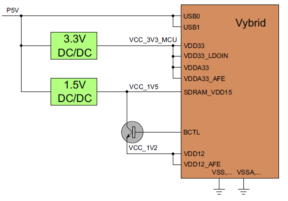

So, in the application note, the collector is connected to 1.5V.

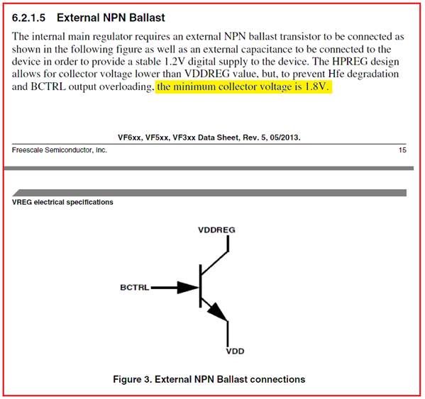

But in the datasheet, the collector voltage is specified for at least 1.8V? Or does i understand something wrong?

  • Regarding 1.2V rail characteristics... This rail is internally regulated, so there is no really max. value in the meaning you are seeking; at the same time, most likely you may use the max. value from the Datasheet table called "HPREG electrical characteristics".
  • If you power the ballast transistor's collector from 1.5V (or even lower - see details below), i.e. the transistor always stays "in the game", there is no switching issues.
  • Regarding the ballast transistor's collector voltage lower than 1.8V mentioned in the Datasheet (you may skip directly to item 3 below):
  1. Using 1.8V is based ONLY on the requirements for the transistor defined in the Datasheet itself. At the same time, in the "example cases" clause on page 17, it reads "By selecting an appropriate high-beta, low-VBE transistor, a lower collector voltage is possible." - meaning lower than 1.8V.
  2. Details of the above approach have been discuss on the Community several times; the thread most relevant for your case is Re: Power supply for Vybrid core.
  3. We are currently working on the document containing all these details (all in one place!); please, see the relevant draft chapter thereof attached. The entire document  (quite recommended to prevent all the possible design issues) is available via your local Freescale support person.
