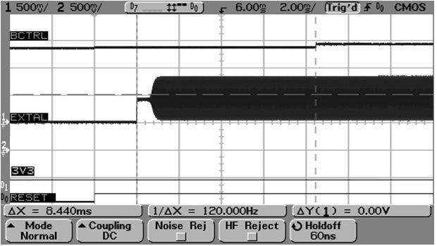

We have some identical boards with the Vybrid Processor on it.
One of them doesnt work from the beginnings, one stopped work after some days of software testing.
The problem is the initializing/start up of the board. When the board is powered up, the line EXTAL goes to 0.6V for about 2ms. Then its tied low again. This is identical on the good and the bad boards.
But then: the good boards set the EXTAL after a while again to 0.6V and the crystal starts working. On the bad boards EXTAL stays low, and the initialisazation stops on the Point /* Wait for PLL lock. */.
What can be the Problem? The boards are (should be) identical, the software is the same...?
Pic1 below: power up, all boards start up like this.
Pic2 below: good boards set EXTAL to 0.6V like on the pic, on bad boards EXTAL stays low forever...
Thanks in advance.

Shown below is what we observe on our boards:
As you can see, both BCTRL (i.e. 1V2, too) and 3.3V are already stable when the RESET goes high, and then the oscillator's bias goes ON, and then oscillation starts.
(The 2 upper, analog, channels are for BCTRL and 3.3V, the 2 lower, digital, channels are for 3V3 and Vybrid RESET).
Sincerely, Naoum Gitnik.

For smooth switching between ballast transistor and DC/DC supply, we switched the FET BCTRL_EN very slowly. On power up, the 1V2 supply goes up also slowly. This seems to be a problem.
On first picture below, the controller doesn't start. On second pic, it starts. (yellow: 3V3, red: 1V2). I'm bit confused, because the start sequence is the same, and the controller is the whole power up sequence in reset state anyway?
But im looking forward to solve the problem... thanks for your help!
