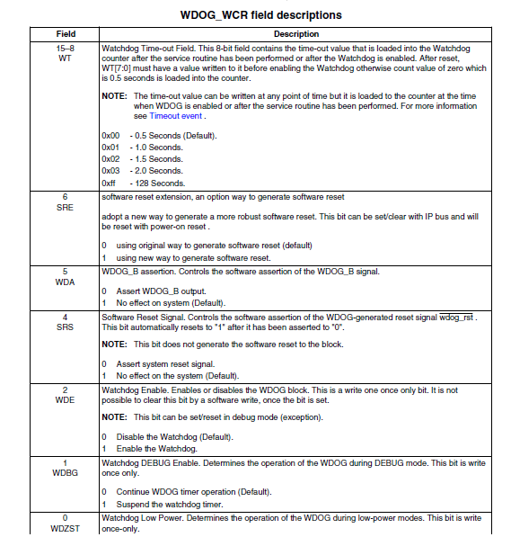

I ask about  manual issue.
The bit array of a figure is different from a bit array of a table in 26.6.1 Watchdog Control Register (WDOG_WCR)/WDOG_WCR field descriptions .(VYBRIDRM.pdf/1136page )
Is bit array of a table right?

A difference between figure and table is as follows
a figure
  15-8 : WT
     7 : SRE
     6 : WDA
     5 : SRS
     4 : WDE
     3 : WDBG
     2 : WDZST
a table:
 15-8 : WT
     6 : SRE
     5 : WDA
     4 : SRS
     2 : WDE
     1 : WDBG
     0 : WDZST

Dear Soichi,
Sorry for taking that long to answer it, but I got clarification that the the bit mapping in the table is correct.
I will request the documentation correction.
Thanks for catching it!
Regards, Naoum Gitnik.

Dear Soichi,
It looks to me like a typo.
Before starting checking it with the design team, may I ask you if you verified the bits use/descriptions in our published code? - This code is tested and quite well commented, therefore it is a trusted source of information.
