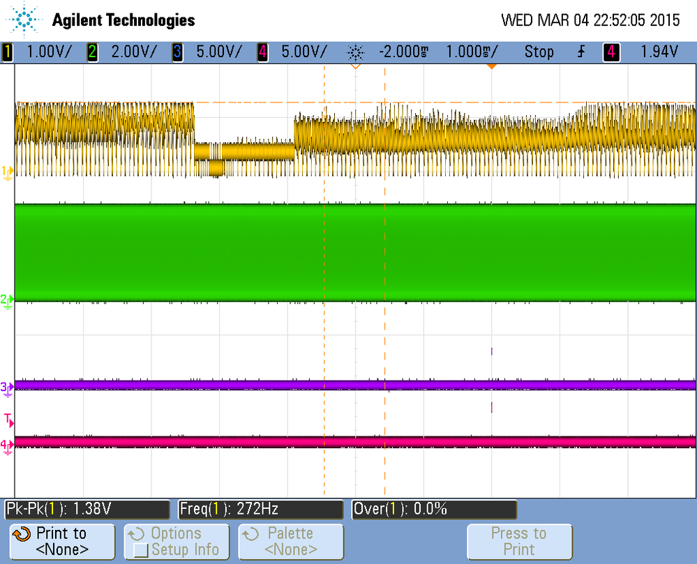

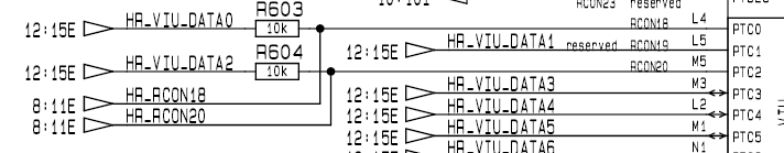

we have checked all lines. If there are correctly connected to Vybrid: there is an issue on the board:
between External ADC and VIU data 2 is 10k resistor:
Measurement1:
Yellow is Analog
Red line is D2 (HR_VIU_DATA2) - before resitor
Green is clk
Light blue are D9 to D2
Red line is D2 (PTC2) - after resistor
So signal on D2 is not correctly connected.

We removed R604 and placed 0R - situation has changed significantly. signal on PTC2 is correct.

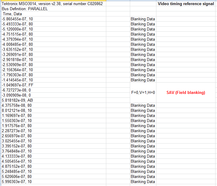

slw
Hi Jiri,
Sorry for my late answer but I was ill the last 2 weeks.

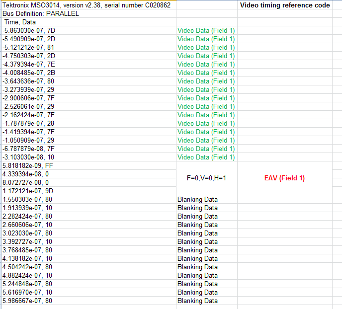

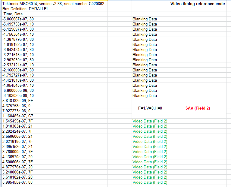

I have attached some example records where you can see the relevant ITU data-stream (SAV/EAV starting 0xFF, 0x00, 0x00).
Sebastian
17,875 Views

Hi Sebastian,
Thank you for data. Those data are on input of VIU interface. Do not understand their timing from those pictures, sorry. Could you correlate those data (frames) with FIELD_IRQ generation, please? In which cases it is generated and at what intervals (add toggle GPIO for example)? Or at least what is interval of FIELD_IRQ generated on your board and is it regular?
/Jiri

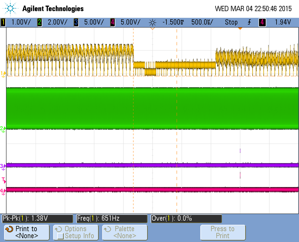

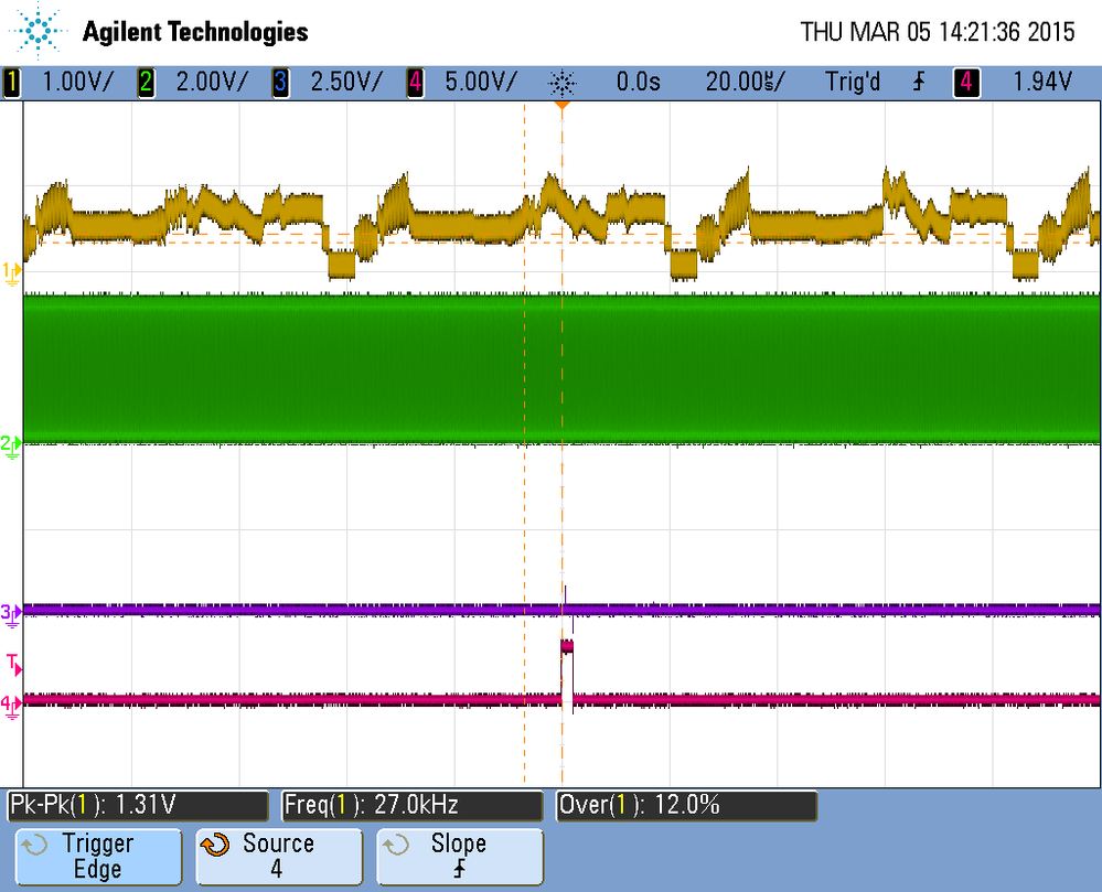

Hi Sebastian,

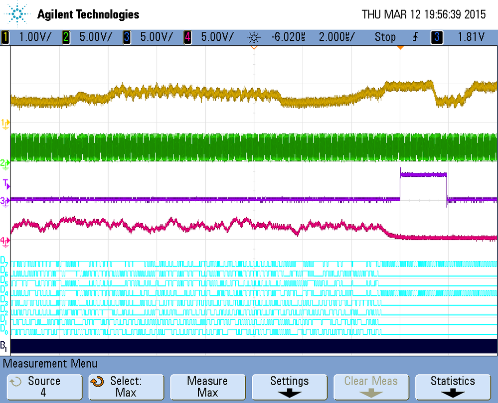

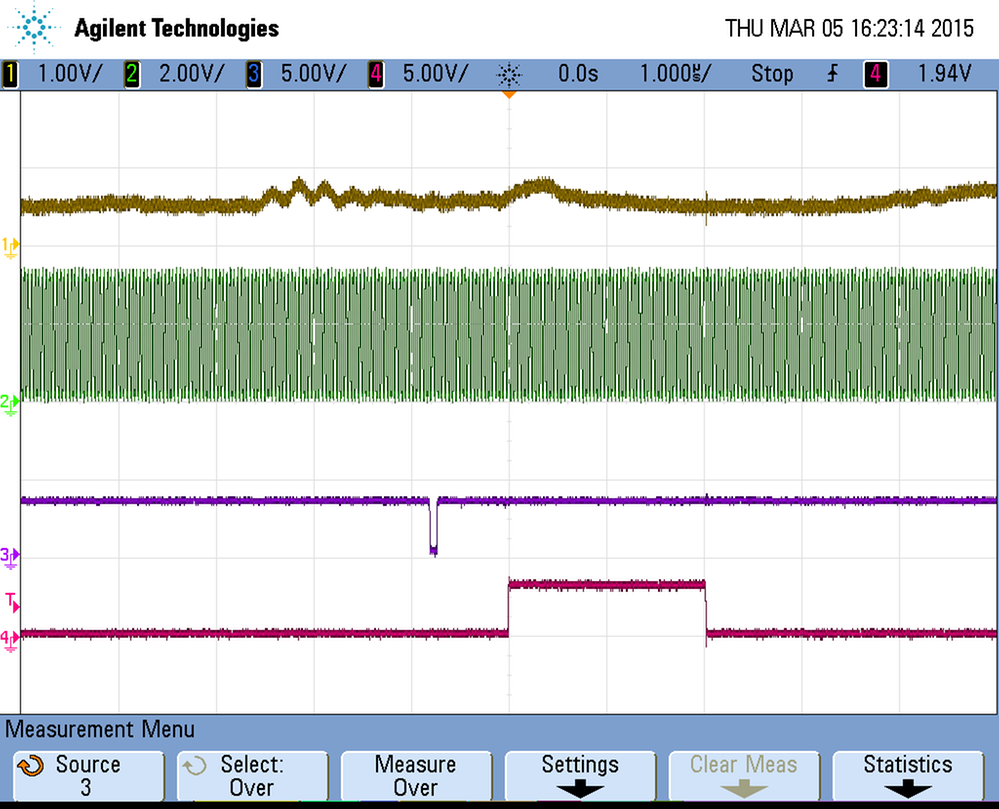

tested alignment on your board. Added pin output debug in VIU ISR.
So far: Field interrupt is not correctly aligned with start or end of the frame:
triggered at start of interrupt routine (peak at CH3 and 4 - trigger). Delay between start of frame and interrupt routine vary from about 300us to 6ms.
Decoding is not correct.
what is interesting it that interrupt comes always at same moment withing a line - in the middle of the line (probably latency). So we can say that it is between lines but not between correct lines:
ISR is alligned to HS from External ADC:
Ch4 is interrupt service routine, Ch3 is HS from external ADC
So wrong setting of Vybrid decoder, wrong setting of External decoder or wrong connection are valid reasons,..
/Jiri
