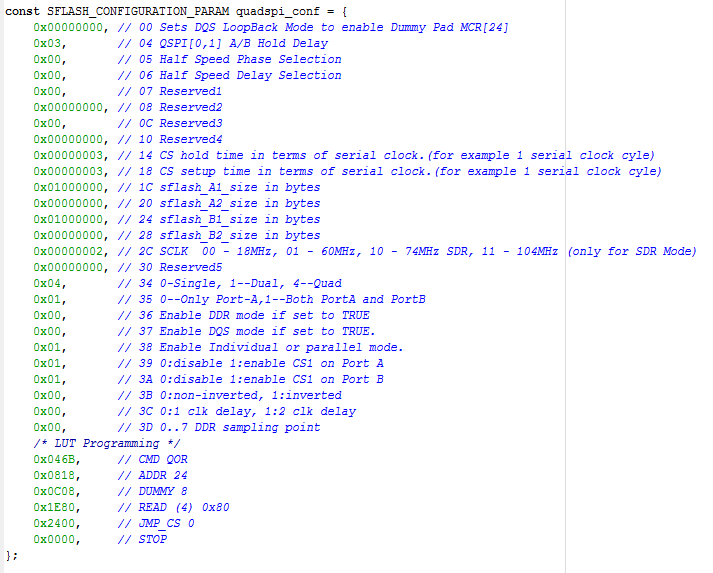

OK. Then we need to go further and check boot config. Since nothing wrong was noticed before, I tried to play with differences of your setup and mine. I'm not familiar with split technique, so I applied your quad_conf settings to my code. And ooops, finally and I got it not working :-).
Your quad_conf claims you have four memory chips, so both CSx chipselects should be used. I tried enabling CS1 for channel A and it worked! I can't explain this without looking at boot ROM source codes. Then I disabled CS1 back and set A2 and B2 memory sizes to 0. It worked again. Works at 99MHz and 60MHz.
Regarding init_hw.c Please check if your code works at both 60 and 99MHz boot speeds. If not, make sure linker uses your supplied file and doesn't link with one from original BSP library.

nancyb
Hi Edward,
Based on your results I performed a series of experiments; changing QuadSPI configuration parameters, setting Vybrid boot configuration to QuadSPI, and power cycling the target. For reference, this is the technique I use to update and verify execution after updating QSPI flash. The bare metal project "hello_world" always boots without issue. My MQX project "hello2" fails boot. Both projects use identical QuadSPI configuration parameters and Image Vector Tables.
First I set A2/B2 size zero; no joy. Then I set Enable CS1 on Port A; no joy. Finally I set Enable CS1 on Port B; no joy. Then I rebuilt and flashed "hello_world" using these values and it executed in parallel mode without exception.
I flashed "hello_world" using all of the above settings with serial clock frequency value (offset 44) set to 1, 2 and 3; all worked.
Setting the QuadSPI configuration parameters has always been problematic for me because when the boot fails I have no feedback to tell me exactly what went wrong. I have had good results copying setup values that other folks have created, such as the LUT to enable quad mode.
Again, thank you for your assistance. I can relate to being "fed up with this a bit". I've been at this tooth & tong since early July. The good news is that I have become quite familiar with rapidly executing my QuadSPI experiments; the less than good news is I still do not have a bootable MQX image.
Nancy
Here are my current QuadSPI configuration parameters settings that work with bare metal image and fail with MQX image:

kef2
Senior Contributor V
Nancy,
please disregard what I said about not working setup with A2 and B2 sizes set to 0x01000000 and CS1A and CS1B disabled. Perhaps I failed to flash that image properly. I tried again and it works well despite of A2/B2 flash size and CS1 enable settings. MQX still is running well in parallel QSPI mode with modified init_hw.c and with your quadspi_conf settings, also tested with 3 speed settings SCLK=1,2,3. No problems.
Could you please confirm again that MQX XIP works for you in non-parallel mode? If it worked, then I'm clueless.

nancyb
Hi Edward,
Things took a turn on Thursday. I made a small change to quadspi_load to read the single/parallel mode from the QuadSPI configuration parameters loaded with the image. Prior to this the selection of single/parallel was selected with a #define. Therefore changing between single and parallel mode required two changes and now there is only one. I tested quadspi_load for both single and parallel mode and both booted MQX hello2 without exception. While running hello2 from QuadSPI I attached to the target, paused execution, reset the debugger and observed the image boot exactly as expected with QuadSPI0_BFGENCR.PAR_EN set to 1.
I have no explanation for why parallel mode works. I am not please to not know why my image works now. I am tentatively declaring victory as I explore this further and possibly understand why it now works.
I observed that parallel mode QuadSPI would not boot unless I applied your updates to init_hw.c.
Finally, some good news. Thank you for your help.
