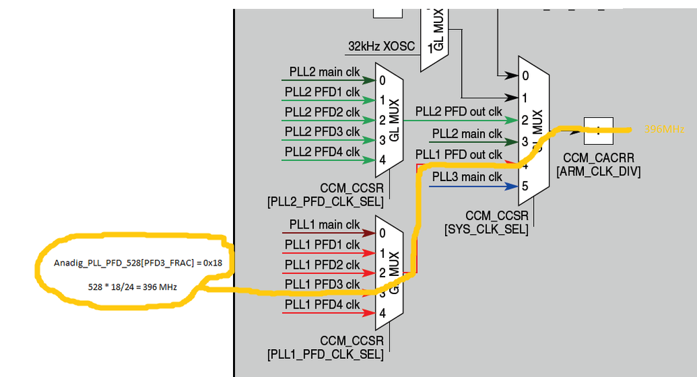

Dear Sir/Madam,
I have a protoype board for VF3x. I am using DS-5 and MQX to test it. Since MQX is prepared for tower kit, the core clock is set to 399 MHz in clocks.init() in init_hw.c file, as below:
    // wait to lock pll
    while ((Anadig_PLL_LOCK & PLL_LOCKS) != PLL_LOCKS);
    // ARM_CLK: SYS_CLK/1 = 396Mhz
    // BUS_CLK: ARM_CLK/3 = 132Mhz
    // IGP_CLK: BUS_CLK/2 = 66Mhz
    // AUDIO_DIV:  73Mhz ??
    CCM_CACRR = CCM_CACRR_ARM_CLK_DIV(0) | CCM_CACRR_BUS_CLK_DIV(2) | CCM_CACRR_IPG_CLK_DIV(1) | CCM_CACRR_PLL4_CLK_DIV(7);
There are definitions for the CCM_CACRR_ARM_CLK_DIV() in MVF50GS10MK50.h file as:
#define CCM_CACRR_ARM_CLK_DIV_MASK               0x7u
#define CCM_CACRR_ARM_CLK_DIV_SHIFT              0
#define CCM_CACRR_ARM_CLK_DIV(x)                 (((uint32_t)(((uint32_t)(x))<<CCM_CACRR_ARM_CLK_DIV_SHIFT))&CCM_CACRR_ARM_CLK_DIV_MASK)
But it is not easy to reach a result from this line for me. How can I set the core frequency to 266 MHz? ( I guess it is the maximum frequency for VF3x)
Thanks and best regards.
Mehmet Ali Ipin

Nothe that Im refering to code in twrvf65gs10 but it should be very similar for vf3 or maybe identical
In clocks_init you should have some seeting for the CCM_CCSR like below:
CCM_CCSR = 0x0003FF24;
which set (among other things)
       CCM_CCSR[PLL1_PFD_CLK_SEL] = 0x3  ----> PLL1 uses PLL1_PFD3
       CCM_CCSR[SYS_CLK_SEL] = 0x4 ----> use PLL1_PFD
The Anadig_PLL_PFD_528 might NOT be set, because using the default RESET values
From Reference Manual the reset value for pfd3_frac is:
    Anadig_PLL_PFD_528[PFD3_FRAC] = 0x18 = d24
This is setting the resulting freq = 528 * 18/24 = 396 MHz, through the next path
For getting the 266MHz Frequency at PLL1_PFD3 you need to tweak the value of Anadig_PLL_PFD_528[PFD3_FRAC] close to 266MHz is
Anadig_PLL_PFD_528[PFD3_FRAC] = d36 = 0x24
PLL1_PFD3_freq = 528 * 18 / 36 = 264 Mhz
SYS_CLK = PLL1_PFD3_freq / ARM_CLK_DIV = 264/1 = 264Mhz
You can try to check if there is a better way to get a closer value to 266Mhz.
You need to tweak different values like Anadig_PLL_PFD_528[PFD3_FRAC], Anadig_PLL1_CTRL[DIV_SELECT], CCM_CACRR[ARM_CLK_DIV], etc.
You can try setting a smaller value in the PFD3_FRAC, so PLL1_PFD3 output is a higher frequency and set a higher divisor value in CCM_CACRR[ARM_CLK_DIV].
