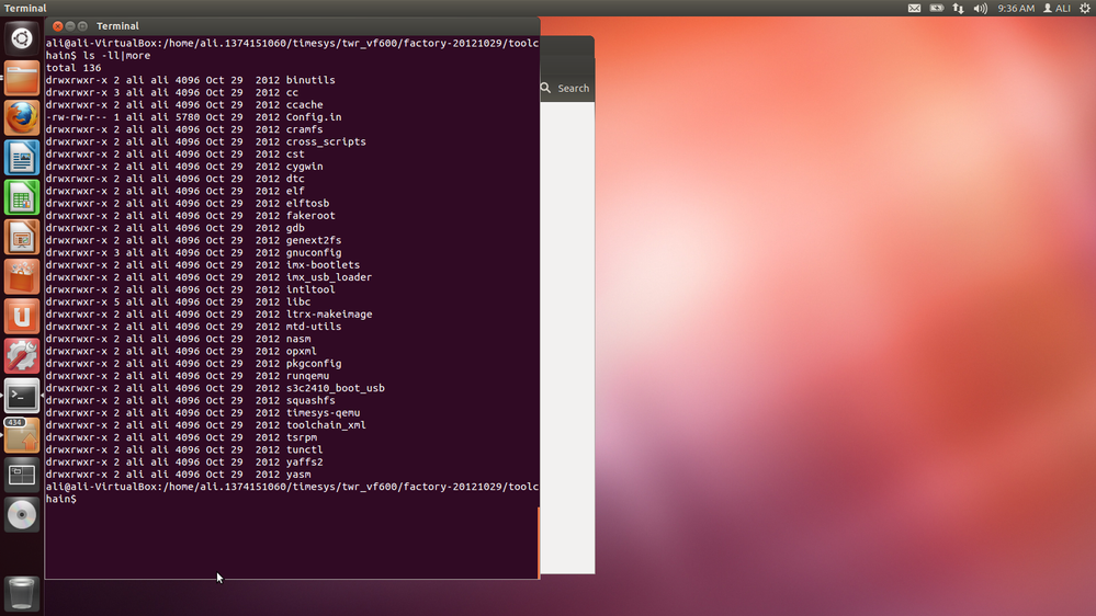

MehmetAliIpin
Contributor V
Dear Timesys,
Thank you very much for your helps.
Since I am using windows for DS-5, my timesys directories are not complete.
When I checked the timesys directory in my ubuntu, I have same directories upto /timesys/twr_vf600/toolchain/
At this point, I have binutils dir, instead of bin. I Don't have bin and its subdirectories.
What should I do for bin and its subdirectories are installed?
Thanks and best regards.
Mehmet Ali Ipin

timesyssupport
Senior Contributor II
Hello Mehmet,
The directory that you are looking at is actually ~/timesys/twr_vf600/factory-20121029/toolchain/. This is the "toolchain" directory located in your top-level Desktop Factory directory. It contains build rules for generating a cross-toolchain - not a cross-toolchain itself. If you have built this Desktop Factory, then the cross-toolchain is located at ~/timesys/twr_vf600/factory-20121029/build_*/toolchain/ .
Another option you have is to download the SDK from one of the Vybrid starting points at linuxlink.timesys.com/download, and install the SDK. The cross-toolchain will be located in the toolchain/ directory of where you install the SDK to.

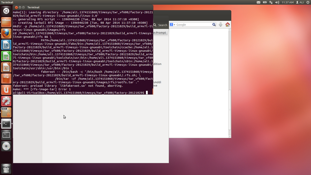

MehmetAliIpin
Contributor V
Dear Timesys,
Thank you for your helps, I run make menuconfig, selected TWR-VF65GS10, and exit. When I run make, I got libfakerroot.so error, as you will see the attachmentScreenshot from 2014-04-08 11-37-51.png
What shall I do?

timesyssupport
Hi Mehmet,
This error can occur if you have moved or renamed your Desktop Factory directory after it was built or partially built. Try running 'make clean && make', which will clean the build and then rebuild.
If the build still fails, I would recommend downloading the latest Desktop Factory at http://linuxlink.timesys.com/download-latest-factory . Extract the downloaded tarball to a new location, copy the '.config' file from the old top-level Desktop Factory directory to the new one, and run 'make menuupdate' in the new Desktop Factory directory and accept all updates. Run 'make 2>&1 | tee log' to build and create a log named 'log' at the current directory. If the build fails, please send the 'log' file and your .config file, both of which will be in the top-level Factory directory. If the build completes successfully, you can find u-boot.imx in build_*/images/bootloader/.

MehmetAliIpin
Contributor V
Dear Timesys Support,
Thank you very much;
make clean && make instruction solved the problem. Now I can see the u-boot.imx in the directory you have written.
