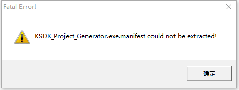

project generator.exe can't open

Hello xiuli,
Which project generator.exe ?  The kinetis KSDK proeject generator ?
What about your system ?
Could you please describe it detail and show the error .

Yes,  The KSDK_Proeject_Generator.exe can not open,my OS is win10.
When I try to open the KSDK_Proeject_Generator.exe,windows prompt a "Fatal Error",
and show "KSDK_Proeject_Generator.exe.manifest could not be extracted!".
picture follow

Hello xiuli,
Sorry for that  so far the KSDK project generator  only support these system :
we can find this on the DOC : KSDK Project Generator Release Notes - 2.0.pdf .
You can test it on other system , and i have test , it also can work on Windows 7 64 bit .
Hope it helps
