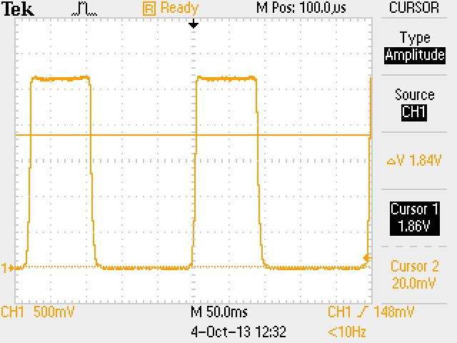

I have about 8 left over TCRT5000L sensors that I picked up for speed sensing.
Using the 3.3V fail, a current limiting resistor of 56 Ohms for the LED, and a 2.2K resistor between the emitter to ground, the photo transistor gives a swing from 0 to ~2.5V when using a mirror (scope plot below of moving the mirror in and out).  I have some left over shiny aluminum foil tape from another project; little squares of it should make a great speed sensing disk.
If anyone wants a sensor and some of the shiny foil tape ($1?), let me know.
