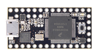

Teensy (Teensy3)
Made by PJRC.  For those that want to put a high performance 32-bit MCU on a breadboard.  Also, per the PJRC website you you are able to use the Arduino IDE.  The hardware is about as bare-bones as it gets, but the nice small footprint and breadboard ability gives you lots of flexibility to add your own custom I/O.

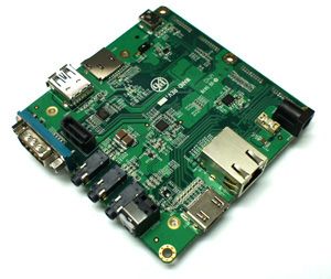

Wand Board.org (Wand Board)
The Cortex-M series is primarily intended for embedded control applications.  Whereas the Cortex-A series is built for graphical and multimedia applications.  Wandboard.org has been getting a lot of attention in the community as a Rasberry PI, Beagle Bone alternative(comparison chart).  Another similar product, still in development, is UDOO so stay tuned for that one.
