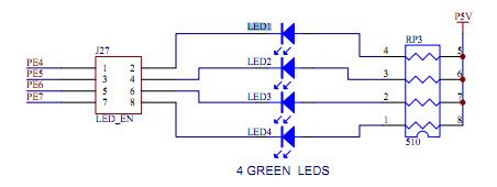

The LED's are located on the board and visible in the board schematic on page 4 as below:
This schematic is found here.

As visible from the schematic - the LED's are accessed via the following ports.
HardwareChip Port/PinComment
LED1PE4
LED2PE5
LED3PE6
LED4PE7
