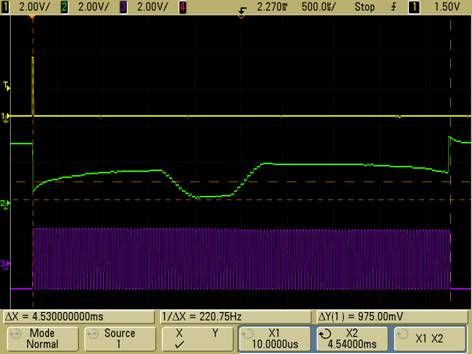

Acutal camera output image:
Yellow = SI, Green = Camera Signal, Purple = clock
More camera waveforms and information (Power Point) available here
This link shows a video of the camera connected to the oscilloscope
http://www.youtube.com/watch?v=YOAd3ERnXiQ
To obtain this signal, connect channel 1, 2 and 3 of an oscilloscope to the SI pulse (Trigger off this signal), CLK, and AO signals.

Once the sensor is perfectly working the next step is to find the best position of the lens that will generate the clearest images.
  1. The best way to do it is using an oscilloscope:
  2. Connect the SI and AO signals to the oscilloscope
  3. Set the SI pulse so that it can be clearly seen and then trig the AO signal with the SI signal using the trig function
  4. Fix the camera looking at a sheet of paper with a black line in the center
  5. The image of the black line will appear on the oscilloscope screen
  6. Screw the camera until you find the position where the line seems the clearest
