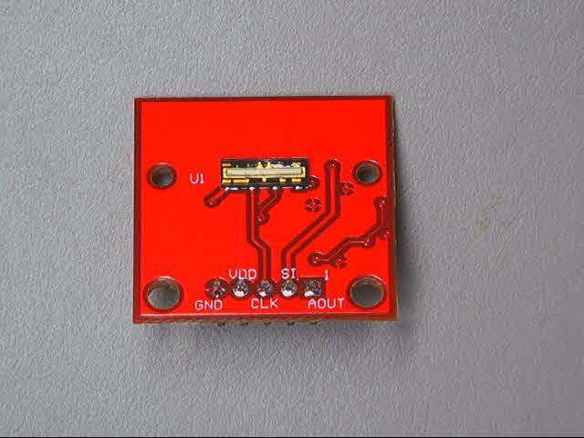

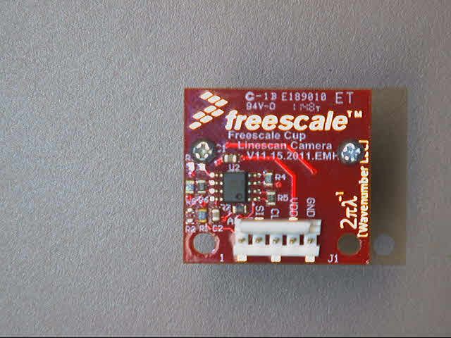

The Freescale linescan camera is based upon the TSL1401CL sensor from TAOS Inc.
Design Files
Images (Lens removed)
Freescale Linescan Camera Specifications
  • 128-pixel linear image sensor (TSL1401CL)
  • Focusable imaging lens
  • 5-pin physical interface on PCB on .100" grid
  • Simple three-pin MCU interface with analog pixel output
  • Lens: 7.9mm focal length, f2.4 fixed aperture, manual focus, 12mm x 0.5mm thread
  • Exposure Time: 267µS to 68mS
  • Resolution: 128 pixels
  • Built-In amplifier stage to improve white/black differentiation.
