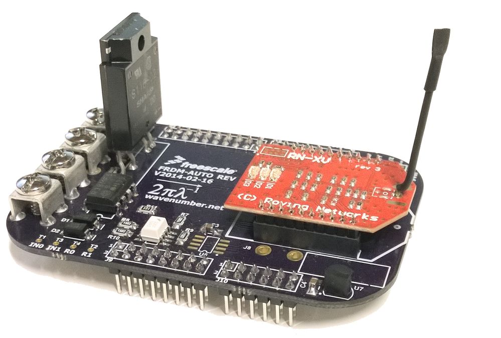

monkey%20plug2.pngIn this project, you will learn how to do basic electrical automation and control via the web.  Think of the NEST.... only more open and hackable!   Using Websockets, Javascipt and HTML5,  you will have a simple way of viewing remote data and be able to control some solid state relays.   This framework will allow you to create more complex IoT applications.    The example will combine a FRDM-K64F and a FRDM-AUTO to read a temperature sensor and control a solid state relay.

Step 1: Get a FRDM-AUTO & FRDM-K64
The build package is on the FRDM-AUTO site.   Note that for this exercise you only need to build the "OPTION 1" version.  Please let us know if you are interested in a pre-assembled version.  If there is enough demand we will get a lot assembled for purchase, I will get a Kickstarter going!   Don't be afraid to build it yourself,  Soldering is fun!  There is plenty of good stuff on the web on how to do SMT soldering.  All of the parts on the board are fairly simply once you get the hang of it and everything can be hand soldered  The key is having some decent tools.
Step 2: Put it Together
Assemble the FRDM-AUTO and K64F.   When you get started, do NOT hook up anything to the solid state relays until you are sure  things are working.
