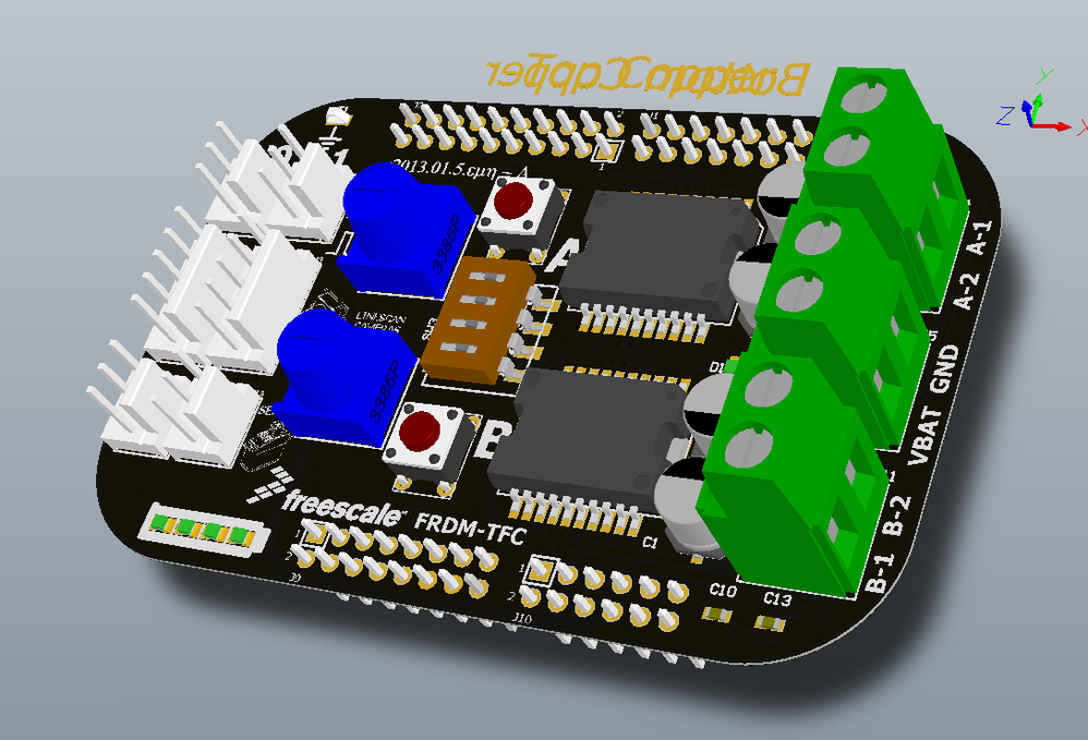

| Boards before 2013 | Current Board |
| Rev. 0 | Rev. 1 |
Revision 1 (Schematics, design files, sample code, instructional videos)

In order to go forward AND backwards, you have to have control over IN1 and IN2 (see table below).
If you look at the schematic, you can see that IN1 is directly connected to GND. In order to enable breaking you need to lift pin 43, solder a wire to it and control it properly.

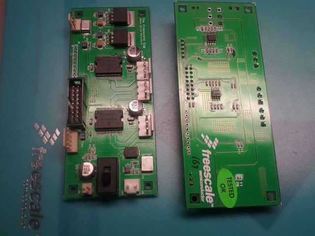

Hey is there a schematic of the actual board with its pins and ports illustrated...
And I have a blue motor board what is the difference with the one that you own?
hi, you can refer the attachment for schematic. i also get the blue one. both are same
Hey Mohamad,
Thanks for the tip, the two boards are indeed the same [green and blue boards], the ports to the DC motors have different names for the boards but it still follows the picture posted in the tutorial. Also I was not sure what the jumper wire was used for, the one between the left motor pin and the right motor pin. Would you happen to know its purpose?
Thanks a lot!
the jumper wire is needed to close the connection for the left motor driver. if not, your left motor will not run. you can also put your right motor cable in to it and leave the right most port vacant so that both motor will be driven by your left motor driver only.

Hey John,
We actually broke one of our pins, but you said that they are easily fixable? I am not familiar with surface soldering...
If you physically broke the pin off the chip it's probably not fixable. If you "broke" it by lifting the pin off the board, that is fixable.
Post a quality zoomed in picture, let's take a look at the damage.
Yeah, the pin actually came off the chip... I'll take a post quality picture though.
Thanks for answering so fast!
Have a nice day!
Hey
I just took the picture I hope you can see clearly, where there is a dent
that is the missing leg.
Thank you
On Feb 8, 2013 9:37 PM, "John McLellan" <admin@community.freescale.com>
Not seeing photo, did you email or put in post?
Here's the picture, my phone did not attach the picture last night... But it is completely off... A solution would be using another H-bridge, but it will require re- routing the current to the H- bridge, which is like designing a new motor board... I am not sure if that's a good idea after all but it would a great learning experience...
