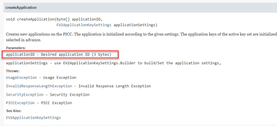

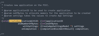

Do you mean the @Param andNumberOfBytes:
This from TL_DESFireEV2.h file?
I will check this internally since the Android JavaDoc function does specify that the applicationID should be a 3-byte number.
Please accept our apologies for the delay this cause to your development timeline. Will let you know as soon as it is updated.
