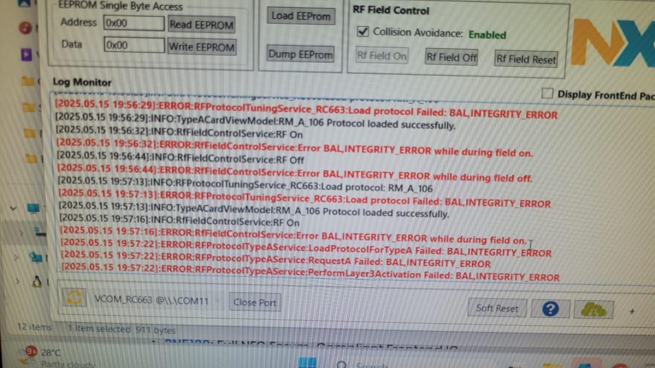

Hi NXP,
I am working on CLRC6630B board. We have succesfuly configured the board, while using cockpit tool we are getting "Time out" error. I have attached the related snaps in this chat. Please go through it and let me know the solution.
With regards,
Bhagyashree B

Hello @Bhagyashree
Hope you are doing well.
I can see that you are using an old version of NFC Cockpit. Please, try using the latest version available in NFC Cockpit > Downloads section and then follow the steps from CLRC663 evaluation board quick start guide, Chapter 3; and NXP NFC Cockpit User Guide.
