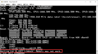

Use SDK-v1.9 to compile T2080RDB board, DDR error appears after downloading Uboot, please send
me a factory default image, I need to start my RDB board,tks.

Please download "Image: QorIQ Linux SDK v2.0 PPCE6500 IMAGE" ISO from https://www.nxp.com/design/software/embedded-software/linux-software-and-development-tools/linux-sdk...
You will find t2080rdb u-boot image in this ISO.
