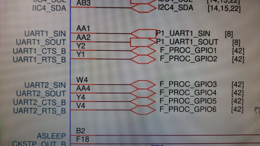

Hi, We are using T1040RDB based and tried changing the value of GPIO's direction and data registers from u boot using MM and MW command. We were able change the values of direction register but not the data register. We have checked the Reset Configuration word values also and it is appropriate.

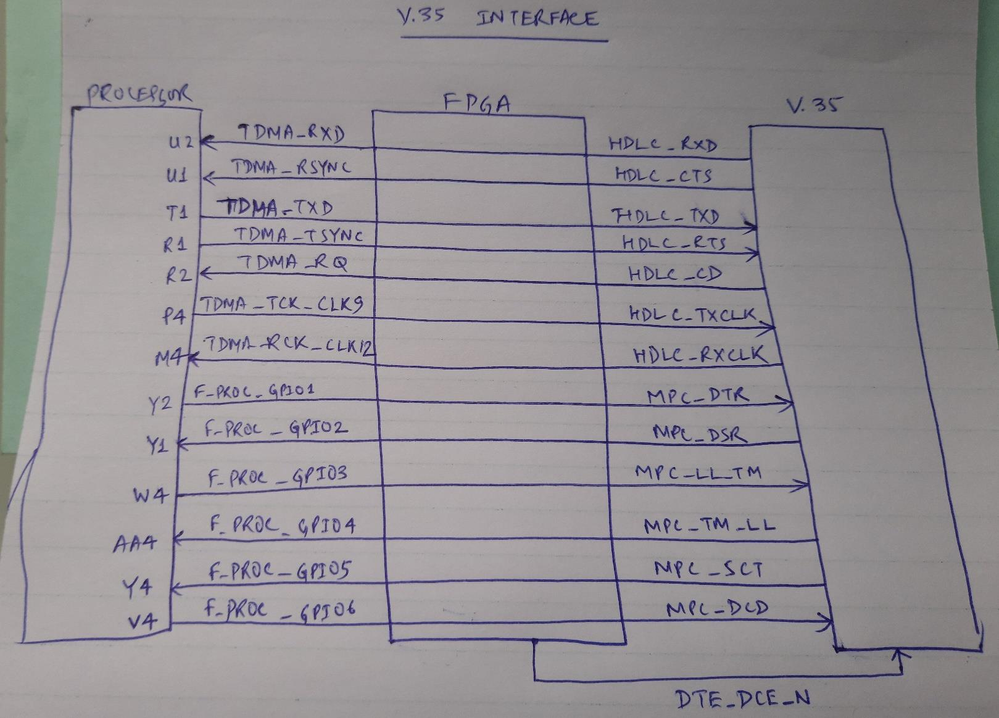

Explain which exactly GPIO signals are probed and how this signals are connected (PDF schematics).

> According to our schematics bits 366-368 needs to be 011(referring T1040 RM). Please find the following dump of RCW.

> Pin Numbers Y2, Y1, W4, AA4, Y4, V4 are the GPIO’s of the Processor T1040 (referring T1040 data sheet). Please find the attached signal diagram that explains the signals of the mentioned pins and these signals are probed.
