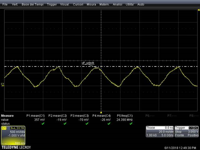

Pavel
Check the USB_CLKIN signal. A write to registers in the USB controller memory map may cause the system to hang if there is no USB PHY clock.
Use the USBx_CONTROL[PHY_CLK_VALID] bit for checking USB PHY clock.

francescocaiazz
Hi Pavel,
thanks for the reply.
Here attached the signal measured on usb clk processor pin.
Could this be considered a valid clock signal?
