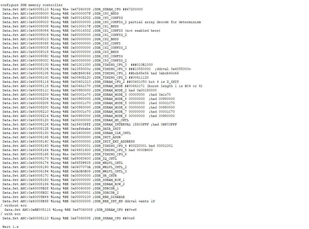

I am using T2080 RDB currently working on the boot of the same. While configuration we have defined SRAM LAW window as well as the SRAM initial configurations as mentioned in the attached screenshots. While testing what we have seen when using a stw command the contents aren'tcopied to the EA but the command executes with no output. When LD command was executed causes failure in previous assembly commands which still havent been executed. Can someone help me with the same.

Could you please provide me a log with the values of DDR registers?

Please find below attached DDR configuration.
