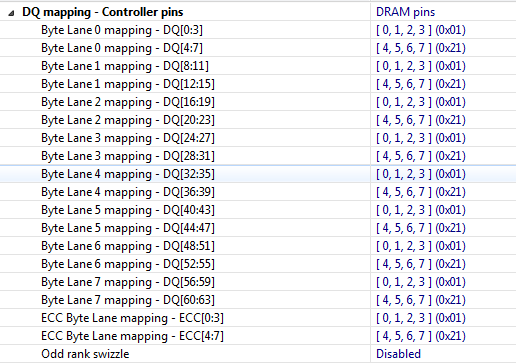

Hi, We are trying to bringup DDR3L discrete RAMs on our custom board. We modified our RCW to set DDR clock frequency to 533MHz. We created a default QCVS DDR3 validation project and ran validation tests. All tests are failing by giving following errors:
Error configuring the target! - DDR initialization failed: D_INIT was not cleared by hardware
We verified signal routing, CLK, CKE and checked signals on probes on all command signals (RAS, CAS, WE, BA, Address etc.) used during DRAM init. However, we noticed two following abnormalities in the signals:
1.  CKE was following init sequence but once it goes high it does not come to low (although CKE_PLS bits are set to use 4 clocks)
2.  Command signals (we tested RAS and CAS) are being asserted for 3~4 clock cycles i.e 7~8 ns when running on 533MHz (although 1T timing is set in DDR controller settings). Please checkout the attached snapshot of RAS signal during init sequence.
Can someone confirm why T1042/DDR-controller is driving these signals with such behavior? Thanks.

ufedor
Points to check:
1) RESET to the DDR SDRAM chips is applied correctly
2) DDR controller DQ mapping settings correspond to the schematics

EmbEng
Thanks ufedor‌.
DDR Chips' reset is asserted with PORESET_B signal and de-asserted with HRESET signal. Although the board is meeting minimum timing requirement of CKE (i.e. CKE must remain low for at least 500us after chips' RESET is de-asserted), the CKE signal remains low for at least 2.5 seconds and then goes high continuously.
Our routing is done on 1-1 basis on all 10 chips, so mapping settings also seem to be correct as shown below:

ufedor
What are the DDR controller registers values?

EmbEng
Please check following settings. Our board has 2 chipselects but we are testing for 1 chipselect only just to troubleshoot the issue:
