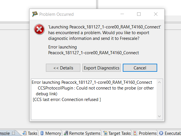

Now I am trying to connect Codewarrior IDE with the target board. I have created the bareboard project as per the instructions given in " Using the Design Checklist for Board Bring-Up (FTF-NET-F0137)' document. But when i do the connect, i am getting an error. The error message is given below. Any idea on what could be the issue?

Thanks for the suggestion.
In my case, it was issue withe JTAG clock set at Codewarrior. Once i corrected it processor is getting detected.

ufedor
The JTAG connection circuit has to be implemented as shown in the QorIQ T4240 Design Checklist, Figure 3. JTAG interface connection.
Ensure that the T4160 is a single device in the JTAG chain.
If JTAG signals pass through a level shifter - use a digital scope to ensure that they are not distorted after the level conversion.
