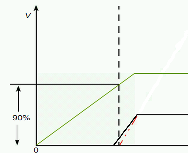

Customer has T1040 power-up question.  They are planning on having all voltage rails come up ratiometrically (see image).  This looks to be OK but they would like verification.

The T1040 data sheet available on the NXP site (link) provides  the power sequencing requirements. It should be satisfied. There are 3 groups of power supplies. There is not ordering requirement with respect to one another in the same group. Groups 1,2 and 3 must be ordered sequentially such that voltage rails on a previous step must reach 90% of their value before the voltage rails on the current step reach 10% of theirs
