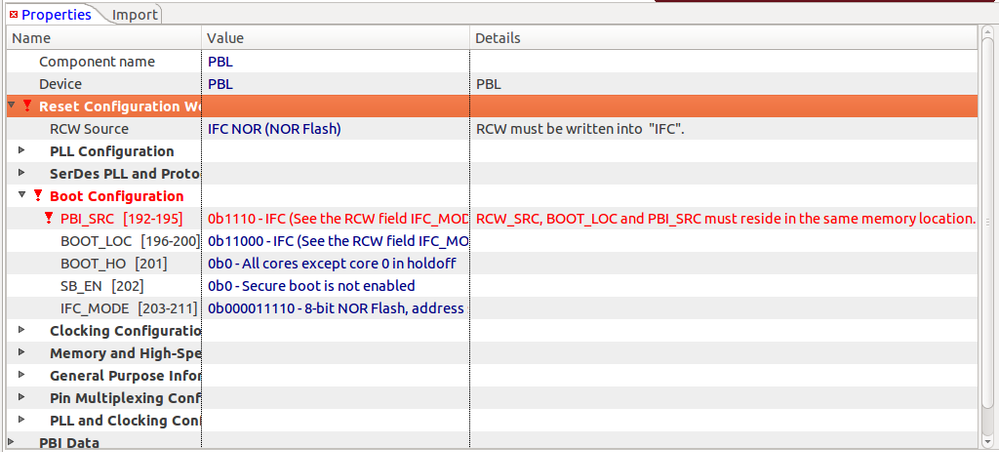

I'm generatin a new RCW with QCVS 4.5 for a T2080 board.
When I try to configure RCW_SRC, PBI_SRC and BOOT_LOC to NOR Flash, QCVS shows an error, why?
When I change PBI_SRC or BOOT_LOC to another interface there is no error.
If I try the same configuration with previous versions of QVCS (4.2.1) there is no error for this configuration.

addiyi
Please upgrade to QCVS 4.5 which is the latest release.
Adrian
8,358 Views
sergiohernandez
Ok, after update no error is show.

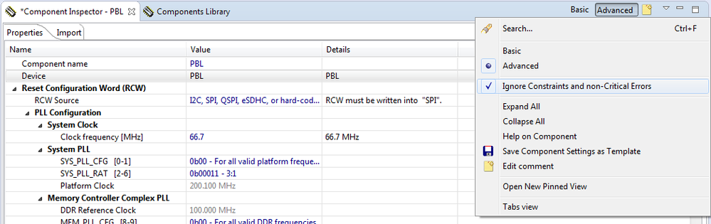

addiyi
It is just an warning. You can ignore it by selecting Advanced tab and Ignore Constrains and Non-Critical errors.

sergiohernandez
Ok, but why it is considered an ERROR, I think it is a valid configuration.

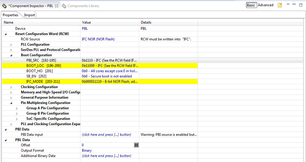

addiyi
No error on my side:
Could you please provide the QCVS build number. Go to Help > About CodeWarrior, click on QCVS icon and provide the version number.
