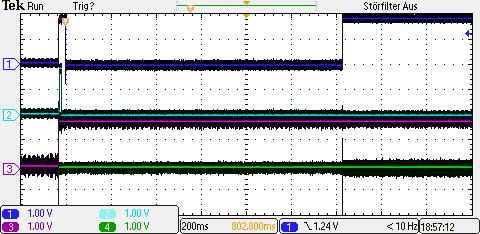

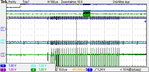

No Flush command. We don't have any PBI data at all (PBI_SRC=disabled), just the RCW.
From measuring reset signals and cs0 (see above) I know that the cpu reads preamble and rcw. But the cpu never deasserts the HRESET signal and the end command is never read.

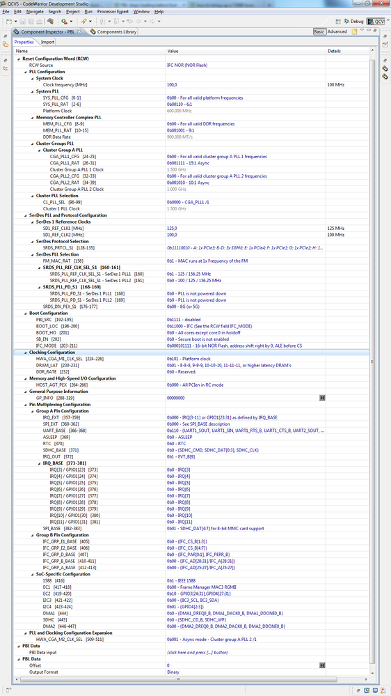

I already compared the signals with an T2080 eval board. From that and FTF-NET-F0152.pdf I know that pll should lock (according to the ratios specified in rcw) before HRESET is deasserted and end command is read. But I cannot find any errors in our rcw settings or input clocks.
Are there any other reasons beside the plls/input clocks which could cause this?

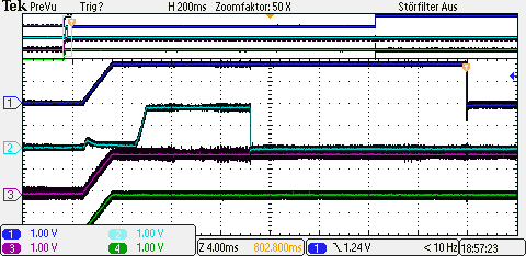

Our system controll FPGA needs some time before it can drive/assert PORESET (see pics above). Could this be a problem (it looks like CPU asserts HRESET before we assert PORESET)?

hreset is asserted before poreset. Is this normal (our reset logic sets hreset to tri-state)?
Reset Signals (PORESET=dark blue, HRESET=light blue, HRESET_REQ=pink, CS0=green):
Details:
CS0 RCW:
My RCW Settings:
