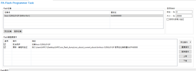

   In my custom board using processor T1014 .When I try to program Uboot.bin into NOR flash, it cannot end when programming to the last sector.
I have done unprotect and erase before program.
The following is the log output by codewarrior :
fl::target -lc "t10104_connect_sram_flash-core00_RAM_T1014_Download"
fl::target -b 0x0 0x20000
fl::target -v off -l off
cmdwin::fl::device -d "lisco-S29GL01GP" -o "64Mx16x1" -a 0xe8000000 0xefffffff
cmdwin::fl::protect all off

cmdwin::fl::image -f "C:\\Users\\MPC1\\Desktop\\MPC\\nor_flash_dump\\nor_uboot_current_uboot.bin" -t "Auto Detect" -re off -oe on -o 0xeff40000

Downloading 0x0000FFFF bytes to be programmed at 0xEFFF0000
Executing program with verify ....

This will repeat the loop and never end.
 My codewarrior settings in below screenshot.
Detrois Huang
2,084 Views
Detrois
I discovered that when I write the same file to the address: EBF40000, it is successful. Therefore, I suspect there is an issue with CodeWarrior. After having the hardware pull the NOR flash address pin to 1 (forcing B to become F), I wrote to EBF40000 again. The experiment was successful, tricking CodeWarrior into writing the value to the address EFF40000 without any errors.
