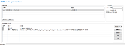

   In my custom board using processor T1014 .When I try to program Uboot.bin into NOR flash, it cannot end when programming to the last sector.
I have done unprotect and erase before program.
The following is the log output by codewarrior :

 My codewarrior settings in below screenshot.

I discovered that when I write the same file to the address: EBF40000, it is successful. Therefore, I suspect there is an issue with CodeWarrior. After having the hardware pull the NOR flash address pin to 1 (forcing B to become F), I wrote to EBF40000 again. The experiment was successful, tricking CodeWarrior into writing the value to the address EFF40000 without any errors.
