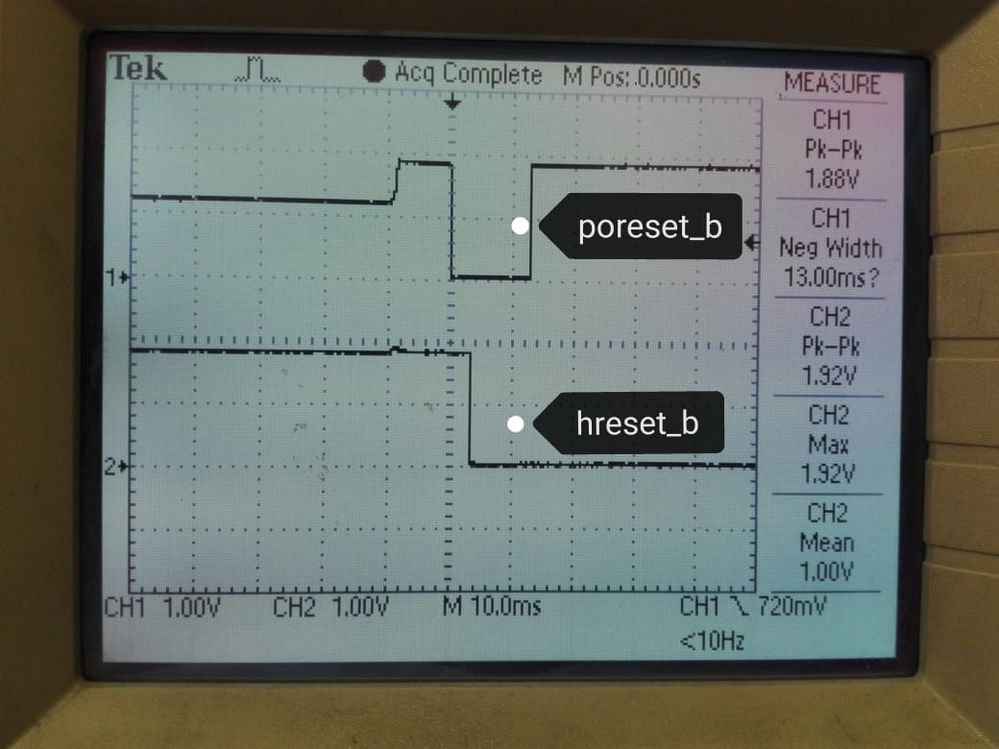

I am using a custom made T1042 based card. I am having problem in one card because of power on sequence of the card. A CPLD is used to follow the power on sequence. As a start when I pull down the PORESET_B signal, then according to power-on reset sequence that is mentioned in Figure 4-1 of reference manual, HRESET_B should also get pull down but this is not happening. HRESET_B is continuously on HIGH state resulting not following POWER on sequence. Hence ASLEEP LED is always on. What might be the issue and the solution to this problem?
I have other boards also with same design but they are not causing this issue with same CPLD Code.

I am using hard-coded RCW settings.
Following are the waveforms of signals with respect to PORESET_B.
Upper signal is PORESET_B and the trigger of the scope is set on the falling edge of this signal. The other wave is HRESET_B in first picture and RESET_REQ_B in the later one.

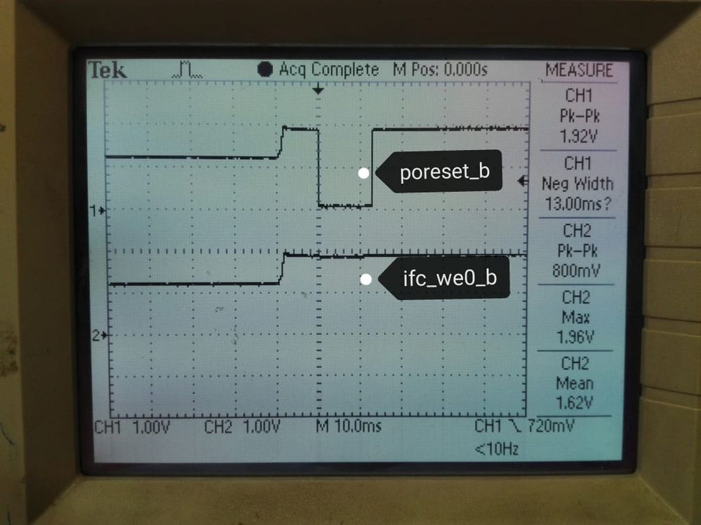

How SYSCLK is applied?
What is the IFC_WE0_B voltage?
19,285件の閲覧回数
athershehzad
SYSCLK is 100 MHz single ended clock generated by an oscillator.
IFC_WE0_B was initially at high impedence state. When PORESET_B was asserted , then it come to 1.8V as shown in the following picture.

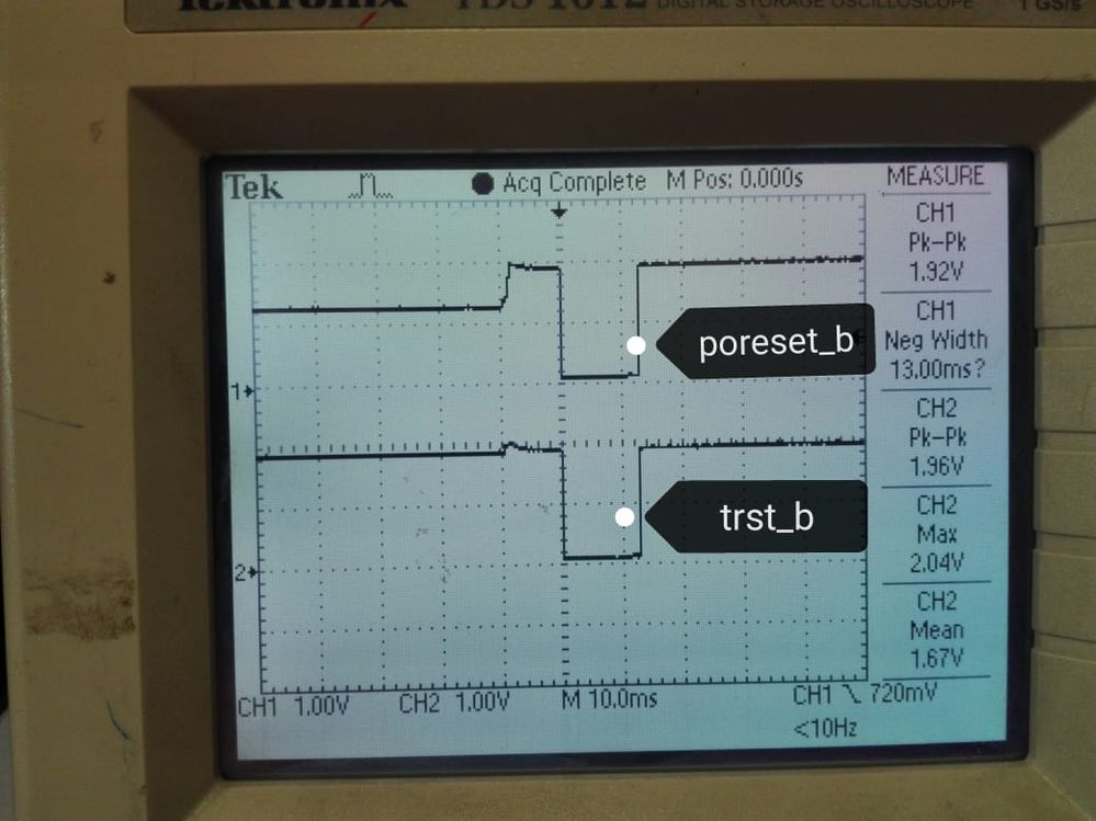

Please confirm that TRST_B is asserted during POR.
19,285件の閲覧回数
athershehzad
Yes TRST_B is also asserted alongwith poreset_b

athershehzad
Thanks @Ufedor for your help.
As per your suggestion, I checked powers of the board and came to know that VCORE was not proper. So after resolving the issue in the power, scenarios of HRESET_B and RESET_REQ_B are changed.
Now HRESET_B gets low after PORESET_B but does not pull high after PORESET_B gets high.
Following are the updated pictures of the signals.
