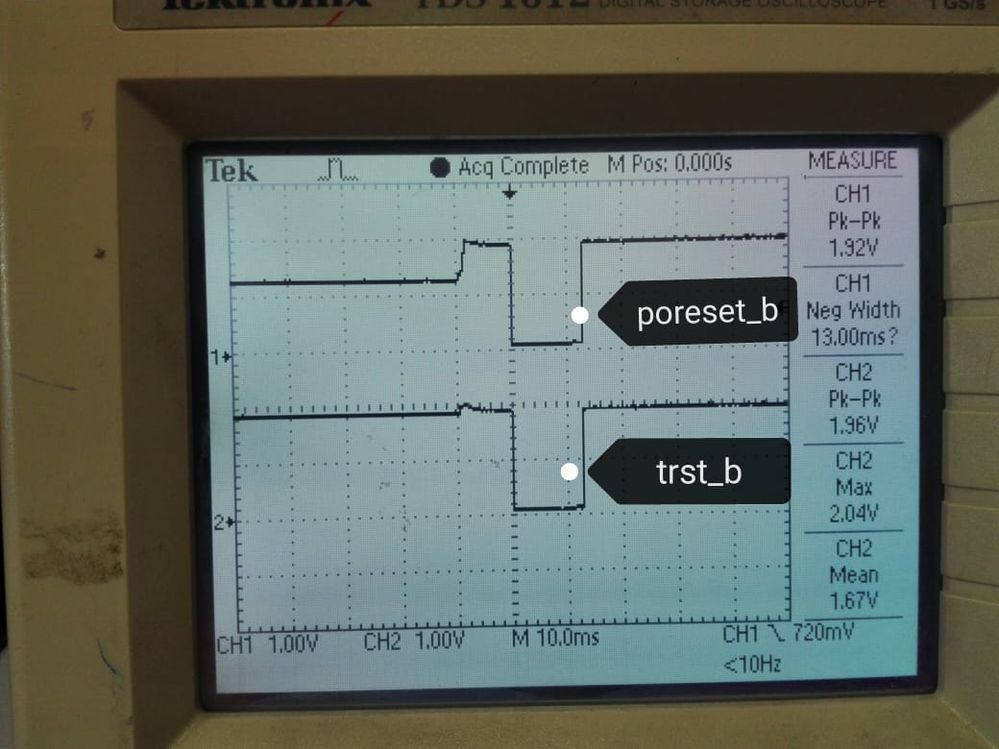

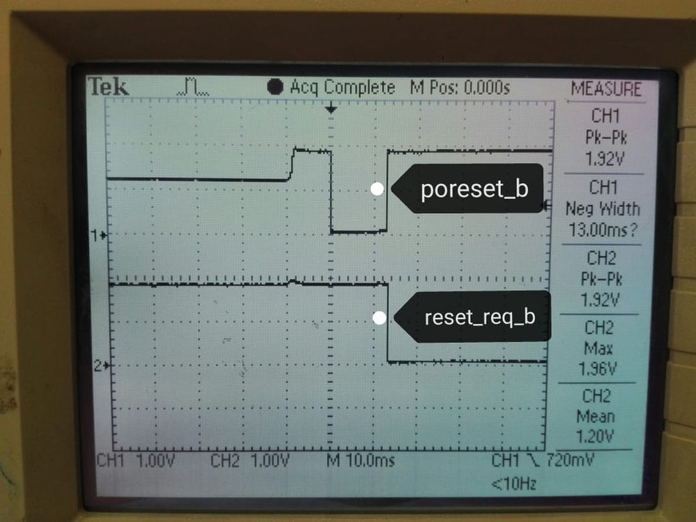

I am using a custom made T1042 based card. I am having problem in one card because of power on sequence of the card. A CPLD is used to follow the power on sequence. As a start when I pull down the PORESET_B signal, then according to power-on reset sequence that is mentioned in Figure 4-1 of reference manual, HRESET_B should also get pull down but this is not happening. HRESET_B is continuously on HIGH state resulting not following POWER on sequence. Hence ASLEEP LED is always on. What might be the issue and the solution to this problem?
I have other boards also with same design but they are not causing this issue with same CPLD Code.
Ather

athershehzad
Thanks UFedor for your help.
I am using hard-coded RCW settings.
Following are the waveforms of signals with respect to PORESET_B.
Upper signal is PORESET_B and the trigger of the scope is set on the falling edge of this signal. The other wave is HRESET_B in first picture and RESET_REQ_B in the later one.

ufedor
How SYSCLK is applied?
What is the IFC_WE0_B voltage?

athershehzad
SYSCLK is 100 MHz single ended clock generated by an oscillator.
IFC_WE0_B was initially at high impedence state. When PORESET_B was asserted , then it come to 1.8V as shown in the following picture.

ufedor
Please confirm that TRST_B is asserted during POR.
19,164 Views
athershehzad
Yes TRST_B is also asserted alongwith poreset_b

athershehzad
Thanks @Ufedor for your help.
As per your suggestion, I checked powers of the board and came to know that VCORE was not proper. So after resolving the issue in the power, scenarios of HRESET_B and RESET_REQ_B are changed.
Now HRESET_B gets low after PORESET_B but does not pull high after PORESET_B gets high.
Following are the updated pictures of the signals.

ufedor
What is the RCW source?
Please ensure that valid RCW is provided during POR.
19,164 Views
athershehzad
Hard-coded RCW setting is being used.

ufedor
Please consider that SerDes PLLs are not powered down and 125 MHz reference clocks have to be applied.
19,164 Views
athershehzad
Thanks ufedor‌ for your help and your precious time.
My board is now in working state. The problem that I identified is that due to faulty TTL to MAX232 coverter IC , I was always receiving high on RX of Debug UART. Hence it was not following Power on reset sequence. Apparently this should not be an issue so I overlooked it previously. But when I disconnected the RX signal from MAX232 IC, the board is now powering up properly.
