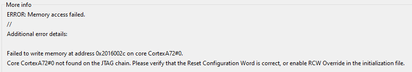

We have a custom board with ls1046a qoriq processor on it. I would like to bring up the board by burning u-boot to the emmc with the CW flash programmer, but while running the target initialization script in CW the error below occurs.
I use the safe RCW in the initialization script. What can be the problem, what does want the CW write at this address?

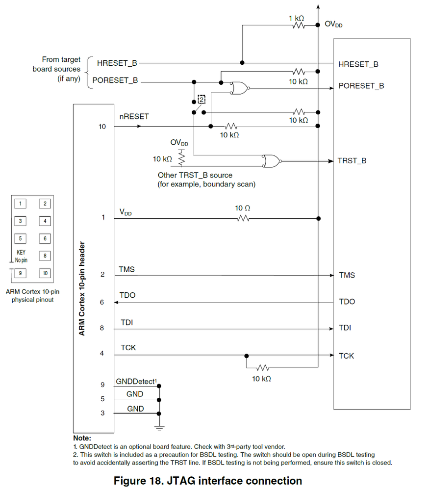

In your CCS log, there is problem at "ccs_reset_to_debug", please refer to the following JTAG interface connection.
Please ensure HRESET not tied to TRST, HRESET to the processor exclusive to COP/JTAG header.

yipingwang
There is no valid RCW on the target board, in CodeWarrior initialization file please modify "USE_SAFE_RCW = True" to use hard-coded RCW.
